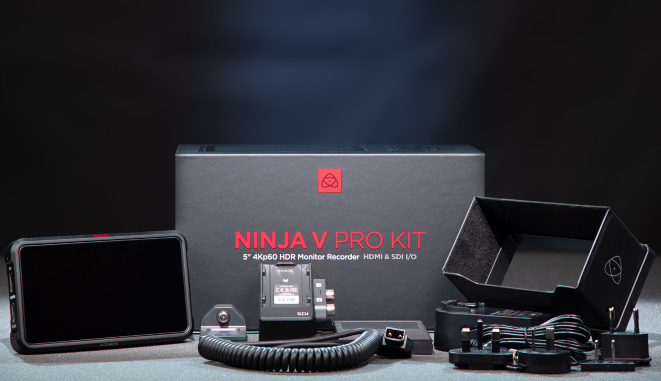

Atomos Ninja V Pro Kit
Atomos has announced the Ninja V Pro Kit, which enables you to record RAW over SDI from select cameras.
https://www.youtube.com/watch?v=Jj_CRJLbzOg&feature=emb_logo
