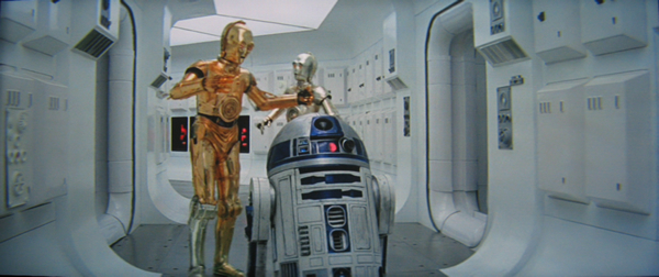

Normal 2.35:1 Movie on a 16:9 widescreen HDTV

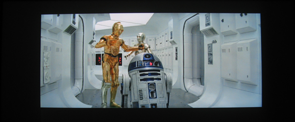

Normal 2.35:1 Movie on a 2.35:1 Cinema Scope screen

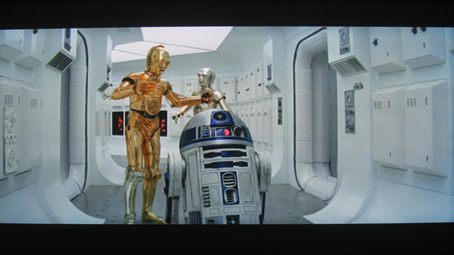

2.35:1 Movie on a 2.35:1 screen in Letterbox "stretch" mode

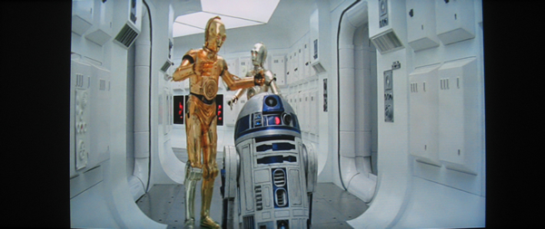

2.35:1 Movie on 2.35:1 screen in Letterbox stretch mode with Anamorphic Lens
