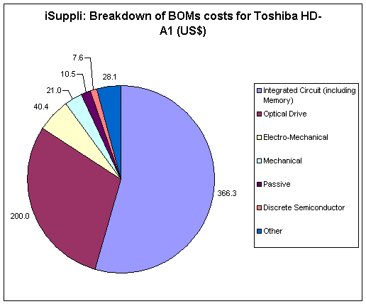

According to iSuppli's teardown analysis, the bill of materials (BOM) cost for the HD-A1 exceeds its US$499 retail price. The HD-A1's estimated US$674 BOM figure excludes costs for manufacturing, testing, cables, remote control and packaging. Those additional costs could easily push the total cost of the HD-A1 to more than US$700 per unit.

Moreover, the HD-A1 utilizes a general-purpose microprocessor instead of more cost-effective application specific standard product (ASSP) semiconductors typically used in consumer electronics products. The HD-A1 employs an Intel Pentium 4 as the main microprocessor, as well as Broadcom's BCM7411 for HD video decoding and four ADSP-2126x SHARC programmable digital signal processors (DSPs) from Analog Devices.
The total estimated cost of these semiconductors is US$137.
The HD-A1 also uses US$125 worth of memory, including a 1GB dual inline memory module (DIMM) from Hynix Semiconductor., three other types of DRAM, a 256MB flash memory disk from M-Systems and 32MB of MirrorBit flash memory from Spansion.
Adding in other chips brings the total integrated circuit (IC) cost of the HD-A1 to about US$247 per unit.
