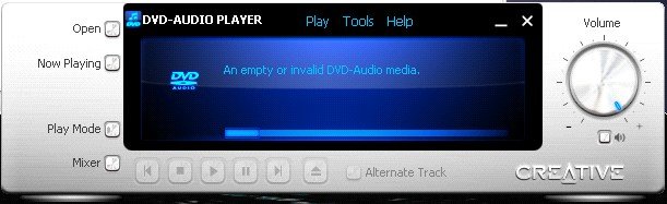

Δεν καταλαβαίνω. Η έκδοσή μου είναι η τελευταία (για audigy 2 platinum) και νομίζω ότι dvd-a παίζεται μόνο με ένα τρόπο. Ο MediaSource dvda player δεν παίζει τίποτε άλλο εκτος από dvda. Δες παρακάτω από το faq της soundblaster:
10 - How do I playback DVD-Audio content with Creative MediaSource?
Creative MediaSource provides a dedicated player to support the DVD-Audio format. The DVD Audio Player offers similar features and usage to the regular player. You can access this DVD Audio Player from the Creative MediaSource Go! Launcher, under the programs tab.
Note that most content on DVD-Audio also contain the same songs recorded through Dolby® Digital and/or DTS® formats which are of lower audio quality. To ensure that you are listening to DVD-Audio content at the best possible quality, please playback DVD-Audio content through the DVD Audio Player of Creative MediaSource
Ο dvda player είναι άλλος από τον απλό mediasource player και οπτικά είναι αυτός:
