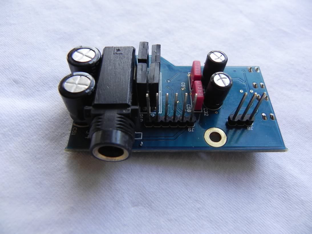

headamp board transistors are B649 / D669
Headamp board opamps are NE5532
Read more: http://rockgrotto.proboards.com/thread/8297/aune-bit-valve-tube-dac#ixzz2xiBoqm3I
