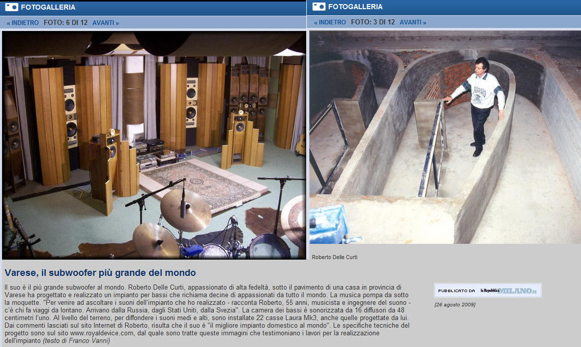

http://www.royaldevice.com/customita3.htm
