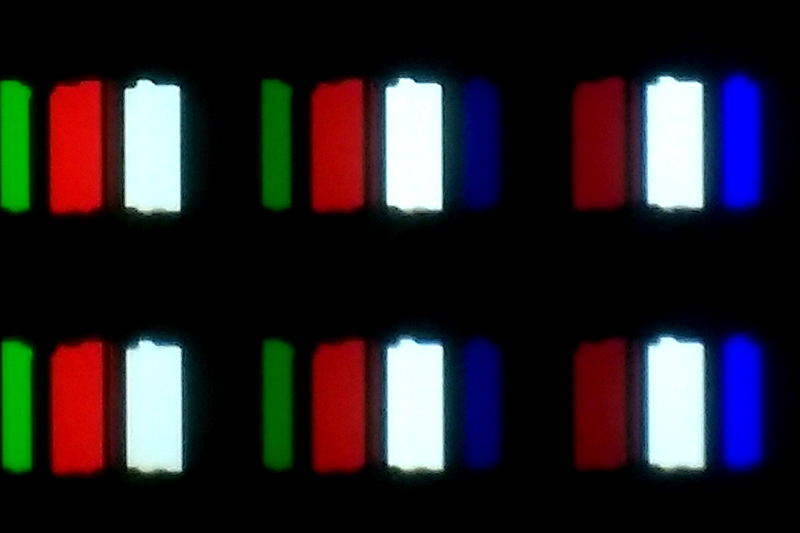

Panel : WOLED + color filter RGBW by LG Display 2022,not equipped with a heatsink unlike the G2.
48",55",65",77",83" : OLED EX (WBE) panel
42" : WBC , later OLED EX (WBE) panel,it is an unavoidable situation depending on LG Display’s panel supply situation
OLED evo_marketing term from LGE:
OLED evo is not a panel name and is a collection of LG's technologies that delivers LG's best picture quality.
LG OLED evo is a combination of cutting edge picture algorithms powered by the a9 Gen5 AI processor as well as OLED technology.
Το OLED evo δεν είναι όνομα πάνελ και είναι μια συλλογή τεχνολογιών της LG που προσφέρει την καλύτερη ποιότητα εικόνας της LG.
Το LG OLED evo είναι ένας συνδυασμός αλγορίθμων εικόνας αιχμής που τροφοδοτούνται από τον επεξεργαστή a9 Gen5 AI καθώς και την τεχνολογία OLED.
WBC vs OLED EX (WBE) WRGB panel Spectral Power Distribution
πηγή : hdtvtest.co.uk

42C2 : WBC panel from LG Display_LGD_SPD_spectral power distribution
maybe later in the year with WBE panel
Peak light output : 691 nits (cd/m2) on a 10% window in Filmmaker mode ,out of box settings .
Peak light output : 117 nits (cd/m2) full field-100% window in Filmmaker mode,out of box settings.
-120Hz black frame insertion removed from LG C2 and I wonder whether this is a decision made by LG Electronics LGE or panel supplier LG Display LGD.
