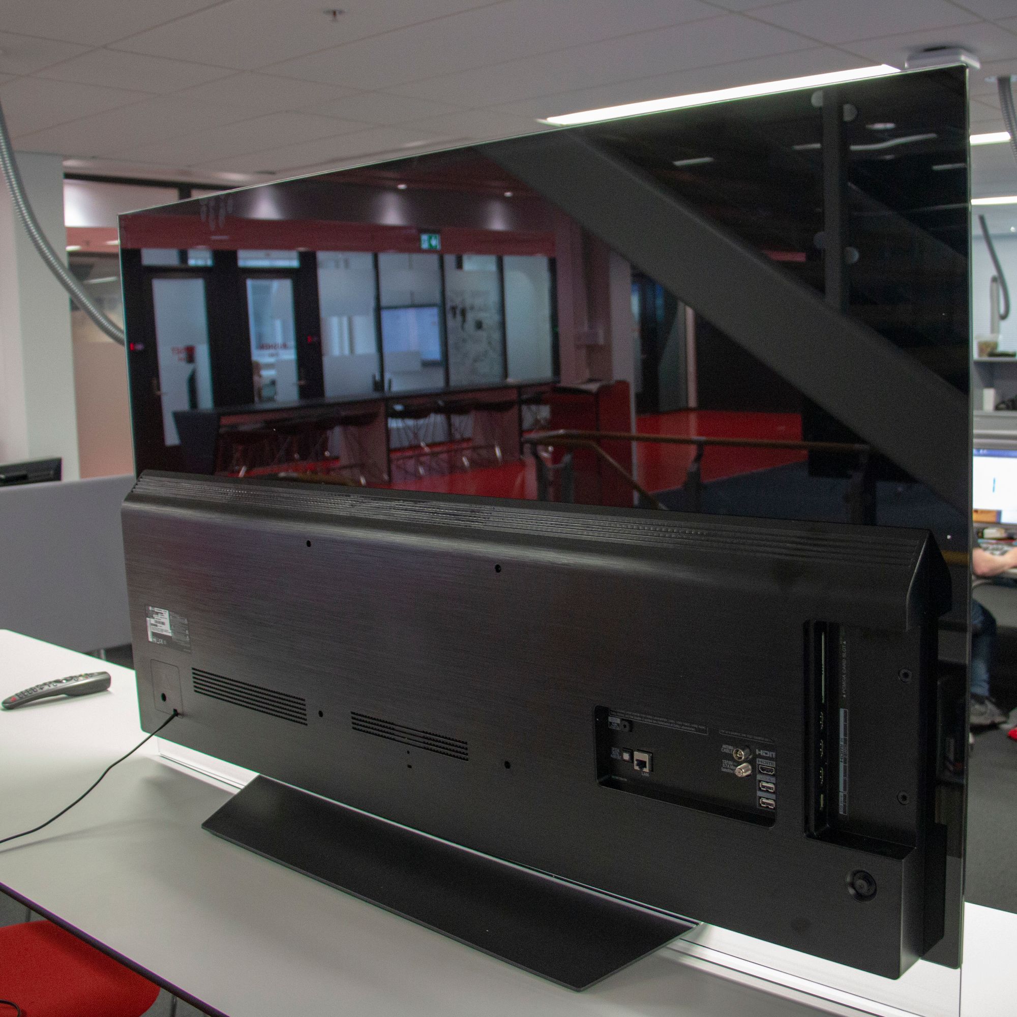

source photo:[tek.no]
source photo:[homecinemamagazine.nl]
