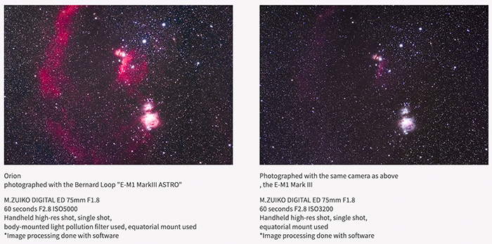

Captures Hα radiation and captures beautiful red diffuse nebulae in vivid, high-resolution images that cannot be seen with the naked eye
The OM SYSTEM E-M1 MarkIII ASTRO has an IR cut filter in front of the image sensor that has been optimized for optical characteristics to achieve approximately 100% transmittance of Hα rays, which are important for astronomical photography. This allows you to vividly capture the beautiful shapes and colors of nebulae that emit light from Hα rays, which are difficult to capture with ordinary digital cameras.

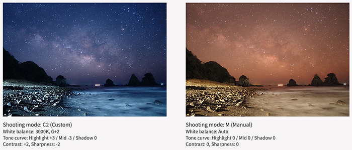

Custom mode includes convenient settings for starry sky photography
To make it easy to use for those just starting out in astrophotography, the camera is equipped with convenient camera settings for starry sky photography in the custom modes C1 and C2 (mode dial). In addition to the initial settings such as setting AF mode to Starry Sky AF and LV Boost to On2, frequently used functions in the astrophotography workflow are assigned to buttons so that they can be called up quickly. In addition, while it is common to finish astrophotography by adjusting the color tone etc. in the post-shooting development process, the custom modes C1 and C2 also have settings suitable for astrophotography, such as white balance and tone curve, so that natural images can be obtained even when output from the camera.
C1 setting: This mode uses Handheld High Res Shot to capture high-resolution astronomical photographs. Use a tripod or equatorial mount to take photos.
C2 setting: Drive mode is set to Single Shot. Image stabilization is set to S-IS AUTO to support handheld shooting.
*Each setting can be changed/overwritten to suit the subject and photographer’s preferences.

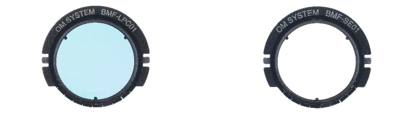

A convenient body-mounted filter for astrophotography
The OM SYSTEM E-M1 MarkIII ASTRO comes with two types of body-mounted filters that are convenient for astrophotography. They are attached inside the camera body (between the mount and the image sensor), so you can still get the same effect even if you change lenses. They can also be used with fisheye and wide-angle lenses, where it is difficult to attach a filter to the front of the lens.
Body mount light pollution cut filter BMF-LPC01
(included in the body mount filter set, sold separately)
Light pollution filters cut out light from artificial light sources such as city lights and street lamps. This prevents color casts in the night sky, allowing you to capture the natural beauty of nebulae and constellations more vividly. In addition, since the area near the horizon is most susceptible to light pollution, light pollution filters are also effective when photographing constellations rising in the eastern sky or setting in the western sky.
Body mount soft filter BMF-SE01
The high-resolution M.ZUIKO DIGITAL lens forms a clear point image of stars, which are ideal light sources. On the other hand, because many stars are recorded as point images, representative stars may not look impressive. By using this soft filter, you can achieve the effect of blurring and emphasizing point light sources, making brighter stars appear larger and more blurred, and the colors of the stars are also emphasized, making the stars and constellations stand out.

Εχουν αφαιρεσει το IR Cut filter εμπρος απο τον αισθητηρα (οπως ακριβως και στις υπερυθρες) και εχουν δημιουργησει μια full spectum μηχανη και στην θεση του IR Cut Filter εχουν βαλει ενα καθαρο γυαλι ωστε η μηχανη να εστιαζει σωστα αλλά επιπροσθετα να βλεπει και να καταγραφει τοσο το υπεριωδες οσο και το ορατο και το υπερθρο φασμα. εξειδικευμένο IR cut filter για αστροφωτογραφια που έχει βελτιστοποιηθεί ώστε να επιτυγχάνεται περίπου 100% μετάδοση των ακτίνων Η, που είναι σημαντικές για την αστρονομική φωτογραφία και την καταγραφή νεφελωμάτων.
Η επιπλέον διαφορα απο τις υπερυθρες ΕΜ1.3 ειναι οτι και με τα δυο εξτρα φλτρα και ειδικα το BMF-LPC01 δινουν επιπλέον τη δυνατοτητα να περιορισουν το φασμα μονο σε αυτο που αφορά την αστροφωτογραφιση ειδικά σε περιοχές όπου η φωτογράφιση περιλαμβάνει κι φώτα πόλης (οποτε μπλοκαρουν ετσι και το υπερυθρο αλλα και τμημα του ορατου).
Θα μπορουσαν να βαλουν το συγκεκριμένο φιλτρο απευθειας στη θεση του IR Cut Filter αλλα τοτε η μηχανη θα ηταν αποκλειστικα για αστροφωτογραφιση ενω τωρα ειμαι βεβαιος οτι με ενα αλλο φιλτρο αλλης διαπερατοτητας σε φασμα ειτε εντος της μηχανης (υπαρχουν απο διαφορες εταιριες τα ιδια στρογγυλα) ειτε πανω στον φακο μπορει να διαλεξεις και να καταγραψεις με την ιδια μηχανη και αλλο φασμα π.χ. το υπερυθρο

Όσοι ασχολούνται με την αστροφωτογραφιση ξέρουν πολύ καλά οτι οι αισθητήρες των μηχανων τους δεν είναι κατασκευασμένοι για να καταγράψουν με λεπτομέρεια τις συχνότητες που εκπέμπει ο νυχτερινός ουρανός. Γιαυτο και κάνουν την ανωτέρω μετατροπή στις μηχανές τους σε εξειδικευμένα service. Εδώ η ΟΜ systems/Olympus πρωτοπορεί γιατί παραδίδει εργοστασιακή μηχανή με την αναλογη μετατροπή.

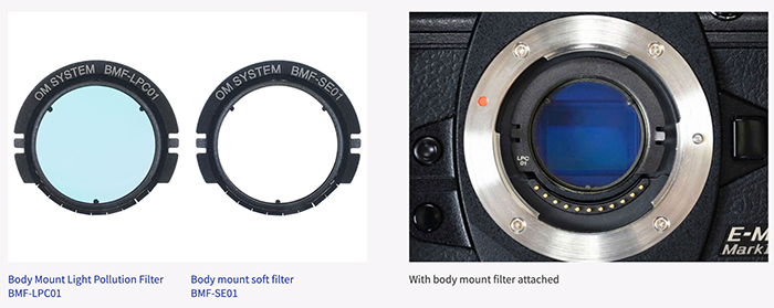

Σε ερώτηση που εγινε στο site της εταιρίας για το αν τα πρόσθετα φιλτρα (τα οποία θα πωλούνται και ξέχωρα) είναι συμβατά και για άλλες μηχανές της εταιρίας η απάντηση είναι :
Q:[ASTRO] Please tell me a digital single-lens camera that can use the body mount filter BMF-LPC01 or BMF-SE01 for astrophotography.​
A:
Our digital single-lens cameras and lenses that can be used with body-mounted light-haunt cut filter BMF-LPC01 or body-mount soft filter BMF-SE01 are as follows. ( As of July 2024)
Digital single-lens camera body
  • OM-1 Mark II
  • OM-1
  • E-M1 Mark III
  • E-M1X ※
  • E-M1 Mark II ※
  • E-M1 ※
※ E-M1X, E-M1 Mark II, and E-M1 do not have the function of starry sky AF. We recommend using it with manual focus.
Lens
  • All M.ZUIKO DIGITAL lenses
※ Other lenses have not confirmed compatibility.
※ Please note that if you use other lenses, the filter may touch the back of the lens and the filter may be damaged.
That's all for the items.
Να σημειώσουμε εδώ οτι αν τα συγκεκριμένα φιλτρα τοποθετηθούν σε νορμαλ m43 μηχανή και χρησιμοποιηθούν για αστροφωτογραφιση θα βοηθήσουν αλλα δεν θα καταγράψουν όλο το εύρος του φάσματος που καταγράφει η εργοστασιακή μετατροπή με την αφαίρεση του IR cut filter.
To έξτρα φίλτρο BMF-LPC01 (light pollution) και το BMF-SE01 (soft focus) θα στοιχίζουν αντίστοιχα ¥41,800 ($258 / £203 / AU$387) και ¥30,800 ($190 / £149 / AU$285) αλλά θα περιλαμβάνονται στην εργοστασιακή μετατροπή της ΕΜ1.3 που θα στοιχίζει ¥327,800 ($2,025 / £1,590 / AU$3,030).

ταυτόχρονα δίνονται και δύο νέα Color profiles COLOR1, optimized for astrophotography/red nebulae και το COLOR2 profile optimized for starry landscape photography καθώς και δύο νέα υπέρυθρα φίλτρα
