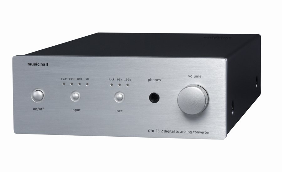

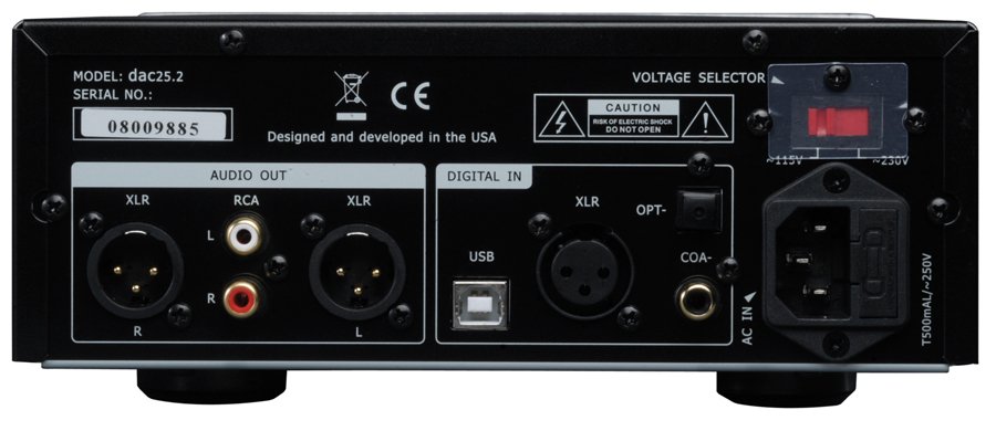

Τα κάνει όλα και συμφέρει στα 595$.Φαίνεται πολύ καλή περίπτωση προσιτού μετατροπέα.
"By uniting a state-of-the-art digital-to-analog converter with a tube output stage the dac25.2 produces the clarity and precision of a 24-bit DAC with the warm, open and natural sound of tubes. The dac25.2 has 4 digital inputs - Coax (SPDIF), Tos-Link, XLR (AES/EBU) & USB digital input for ultimate compatiblity with virtually any source. When input a digital signal from an iPod transport (Wadia), computer, media server, Sonos, Squeezebox, CD or DVD transport, the dac25.2 will output gloriously rich two channel music either to your system via the RCA or XLR (balanced or single-ended) output jacks or through its own built-in, high-quality headphone amplifier.
The dac25.2 features the latest Burr-Brown PCM1796 24bit/192k, advanced segment, stereo audio DAC. This processor features 123dB dynamic range, an 8x oversampling digital filter, and achieves a miniscule 0.0005% THD. The dac25.2 will upsample incoming signals to either 96kHz or 192kHz at 24 bits, with user selectable, front panel control. To achieve the best sound, Music Hall uses an advanced asynchronous reclocking and anti-jitter control system upstream of the PCM1796 DAC, a Philips 74HC574, in conjunction with a Ti SRC4192 Asynchronous Sample Rate Converter, whose master clock is a high precision active crystal oscillator. To ensure a lifetime of flawless operation, the dac25.2 uses an oversized, high current power supply.
Features:
Electro-Harmonix 6922 tube output
• Ti PCM1796 24bit, 192kHz DAC
• Ti SRC4192 Asynchronous sample rate converter w/high precision active crystal oscillator master clock
• User selectable 96kHz or 192kHz upsampling
• Sophisticated asynchronous re-clocking and anti-jitter control system
• 8x oversampling digital filter
• 4 digital inputs: coax (S/PDIF), optical, XLR, or USB
• Analog outputs: RCA (Pr) & XLR (Pr)
• Headphone output with adjustable volume control
• Large high current oversize power supply
• Thick brushed-aluminum fascia and solid chassis
• 110v/220v voltage selectable transformer
• Detachable power cord
Specifications:
THD+N: <0.04% Tube out (1KHz)
<0.0015% Balanced out (1KHz)
Output level: 2.0V
Frequency response: 2Hz~20KHz +/-0.2dB
S/N: >110dB
Power dissipation: <30W
Dynamic range: > 120dB (24 bit)
> 96dB (16bit)
Crosstalk: <-110dB
Operating temperature: 0° ~ 40°C
Headphone output level: 4V max
Headphone output resistance: 0.3Ω
Power supply: AC115V/60Hz - 230V/50Hz
WDH: 8.5 W x 13.5 D x 3.75" H
Weight: 8 lbs".
