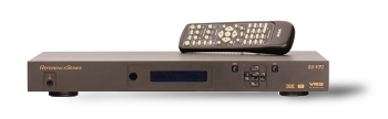

Νεος Video Processor απο την JVC (RSVP2)
takisot
17 June 2006
30,606
Παλλήνη
Ουσιαστικά πρόκειται για εναν DVDO VP50 Pro, o οποιος εχει επιπλεον 2 preset για την σωστη χρωματικη αποδοση των προβολεων της JVC συμφωνα με τα προτυπα SMPTE-C (Rec 601) που χρησιμοποιουνται (ακομα) κατα το mastering των κινημ. ταινιών.
Τιμη: 3.695 $ και διαθεση τον Απριλιο στις ΗΠΑ.
The RSVP2 converts standard definition, high definition and PC signals from your DVD player, HD-DVD player, Blu-ray Disc player, HD DVR, game console, or PC to any output resolution up to 1080p. The processor incorporates HDMI 1.3 compatibility and is THX Video Certified. THX Certification is the industry's hallmark of quality, usability and compatibility.
The RSVP2 also incorporates ISF Day/Night Modes.
A feature unique to the RSVP2 is a "Color Gamut" menu with options for Wide, RS1, or RS2. This enables the operator to easily shift the output color space of the processor to match the SMPTE-C broadcast and telecine mastering standards most commonly used in production today. Color space is remapped inside the processor with a 3x3 "Look Up Table" (LUT) through a series of complex algorithms utilizing 14-bit processing to ensure accurate color reproduction on either the DLA-RS1X or DLA-RS2U without additional contouring in the image.
Key Features:
HDMI 1.3 Inputs (4) that process up to 1080p-24/25/50/60
THX Certification
ISF Preset Color Gamut Control Day/Night Modes
Two Programmable 12V triggers
Upgradeable to SD/HD-SDI Input
Analog HD Transcoding and Processing
Flexible Input and Output Aspect Ratio Controls
Display profiles for multiple display, framerate, and image shift configurations (10)
10-bit, 300 MHz Instrumentation Quality DACs (2x Oversampling for 1080p)
Full-frame Timebase Correction
High performance, multi-standard video decoder (10-bit: 480i/576i; 12-bit: 480p/576p/720p/1080i)
High-quality super-adaptive comb filter with 2D Y/C separation
Ακούγεται όμως σχετικά plug-n-play για τους ιδιοκτήτες RS1 & RS2.. Ειδικά αν αυτοί δεν έχουν και τρελές απαιτήσεις.
Από την άλλη βέβαια, τόσα χρήματα που κοστίζει, να μην έχει και ένα CMS..
Ίσως σε κάποιο κρυφό μενού..
