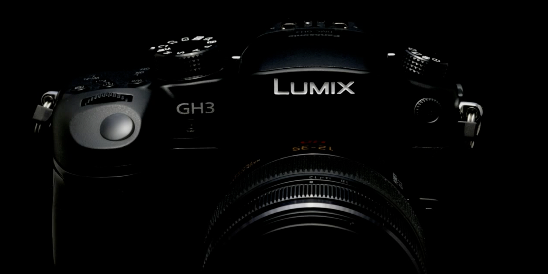

Διέρρευσαν οι πρώτες φωτογραφίες σε video που ανέβηκε στο youtube (και μετά βέβαια αποσύρθηκε):
[video=youtube;kjFeMkgEv-0]http://www.youtube.com/watch?feature=player_embedded&v=kjFeMkgEv-0[/video]
Στο βιντεάκι, στο κινηματογραφικό κομμάτι, ο φακός που χρησιμοποιούν είναι ο zuiko digital 14-35/2 ;)

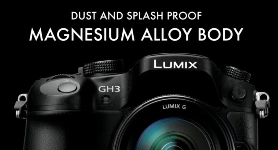

Νεώτερα για τα τεχνικά χαρακτηριστικά της gh3 (43rumors.com):
the GH3 “unofficially” has uncompressed video out. Meaning while its a hardware feature its not one that will be advertised by Panasonic.
The GH3 has multi aspect ratio sensor! But don’t get too excited as the multi aspect function is disabled in the original firmware.
WiFi mode will allow wireless monitoring of video or stills with a tablet or smart phone.
WiFi mode will transfer either raw or jpegs to a tablet or smart phone but if you shoot raw+jpeg you can’t just transfer jpegs, you must transfer both.
WiFi mode can automatically upload jpegs to social media.
UPDATE: Uematsu confirmed at Techradar that “focus peaking could be added with a firmware upgrade“.
