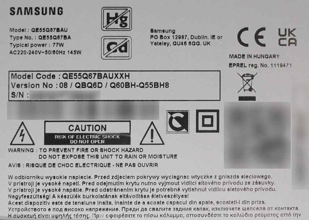

Σε κατάστημα πέτυχα την QE65Q60B με PLS panel (like IPS),version number : 03

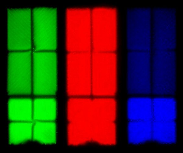

VA panel,RGB,8-domain

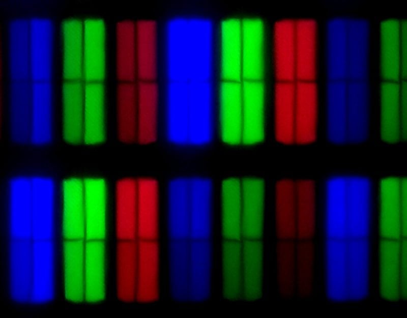

VA panel,4-domain,RGB vertical stripe

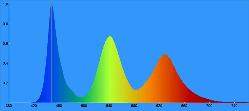

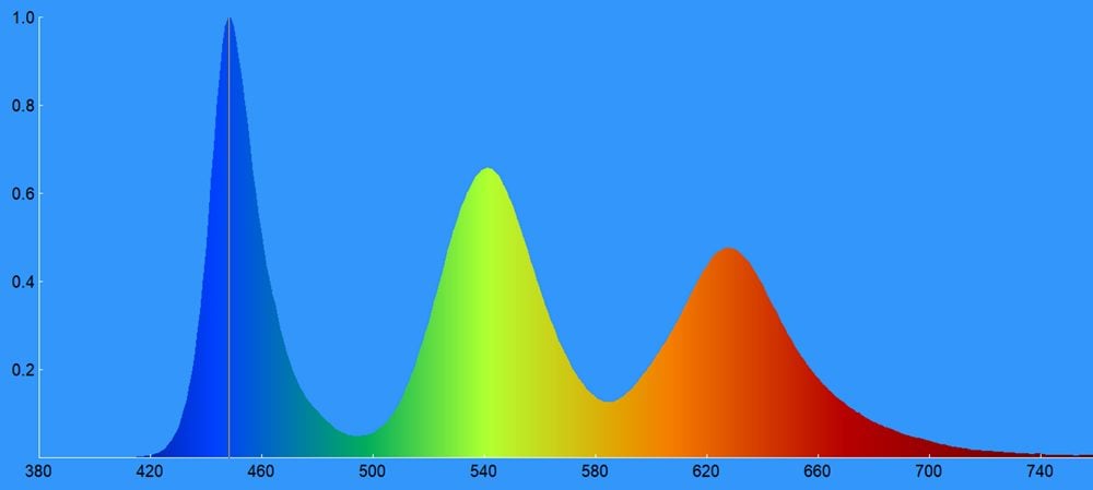

Spectral Power Distibution =Spectral analysis of white,filmmaker mode

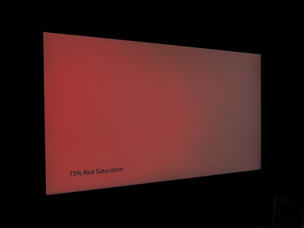

At an angle, the colors fade and darken in a typical VA panel,4-domain LCD panel, as you can see in the picture below.
Vertically, this phenomenon is even more intense than horizontally.
