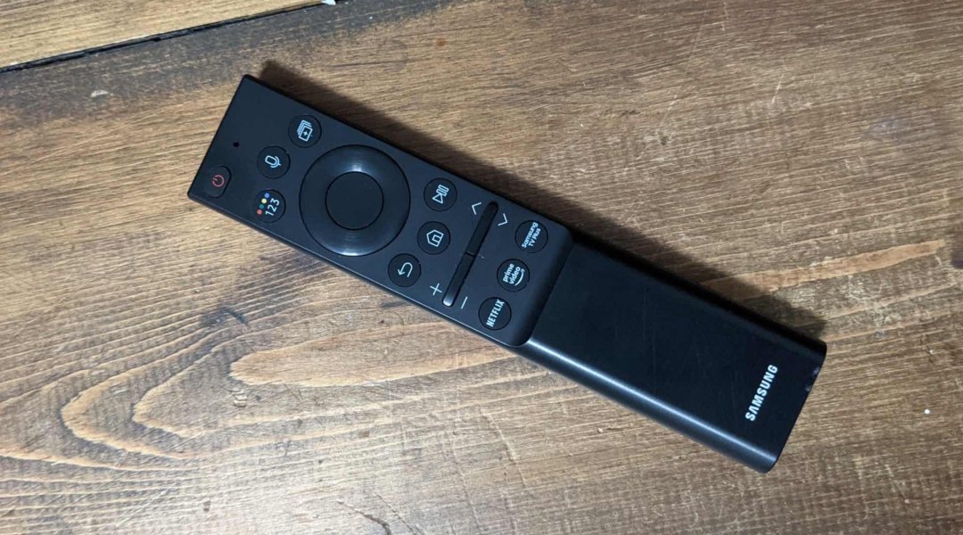

Remote control : TM2180E (solar) usb type C

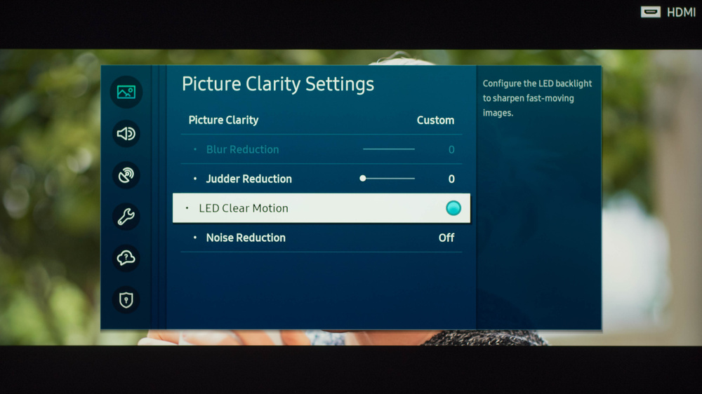

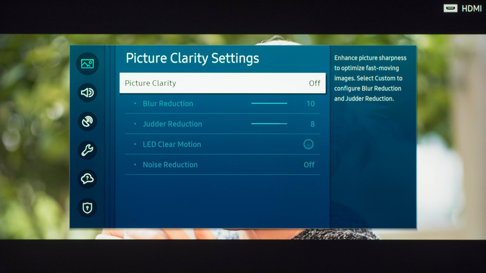

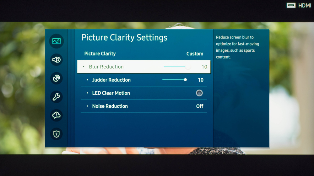

Image Motion Settings:
Custom:
Blur reduction. : 10
Judder reduction: 6-8
Led Clear Motion: Off
Noise reduction: Auto or Off
