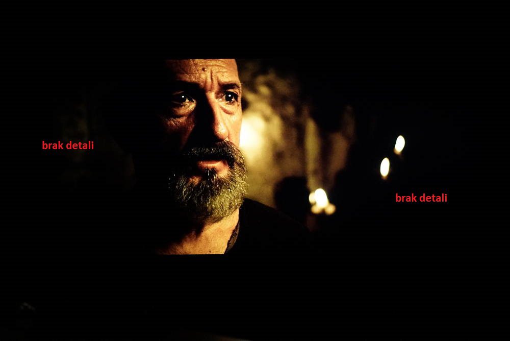

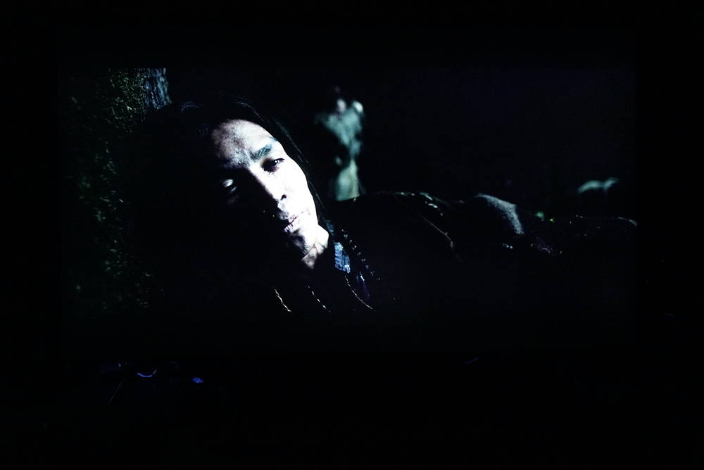

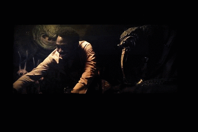

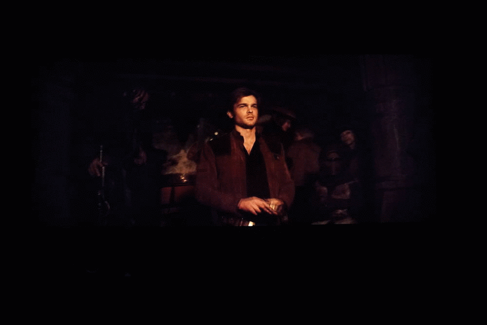

...we should note that we tested version 2 of this model (Version No. 2). This version of the TV uses a VA LCD matrix, most likely from AUO.
As a rule, VA matrices provide higher contrast than IPS LCD matrices, but at the cost of worse color reproduction when viewed at an angle...
...Although the matrix itself has a high native contrast, Samsung engineers have decided to "increase" the contrast by additional methods. Three techniques were used:
local dimming (local blanking of the LEDs),
frame dimming (darkening the entire frame),
manipulation of the brightness curve....
...the backlight control algorithms are slightly better refined than last year (2018). Indeed, their operation is very interesting, because a lot of emphasis was put on preventing the formation of any halos or light envelopes around bright objects. To this end, even if a bright object (e.g. a lamp) is in the center of the screen, the control algorithm "lights" the entire horizontal row of zones behind the screen, not just one or two zones directly below the object. In this way, blooming halo was avoided), because there is no border between the stronger and less highlighted area.
The operation of the algorithm is so unusual that it can sometimes resemble the work of ... edge lighting (with LEDs located along the vertical edges of the screen).
...The other way to "improve black" is running in the background, non- switchable global dimming and brightening the entire picture frame (so-called frame dimming ). On the one hand, especially when compared to QLED AD 2018 TVs, it works more subtly, but compared to the 55Q60R model it works more aggressively. This can be seen very clearly from the scene from the movie ( Revenant , 2015), when after the scene with sparks rising from a burning bonfire the camera shows the face of Hawk (son of the main character) resting under the tree.
...With the naked eye, not only the sudden decrease in brightness of the whole frame was noticeable, but also the loss of detail visibility in the shadows. Interestingly, when subtitles appeared on the screen, the reverse phenomenon occurred ... this time I will illustrate the scene from the movie Solo (2018)...
In general, the operation of the dimmable diode has its advantages and disadvantages. The advantage is great black, which gives the impression of almost that of OLEDs. On the other hand, this tar black absorbs details like a sponge with water. Here is an example:
...Can anything be done about it? Please note that we are talking about the factory settings of the movie mode . You can use the contrast enhancer function low. and / or move the gamma slider to the right. In addition, professional calibration could help the most, although, in my opinion, it will not be completely effective, because the algorithms for blanking and manipulation of the brightness curve are unfortunately beyond the control of the calibrator, and the local dimming system cannot, traditionally for Samsung TVs, be completely turned off....
