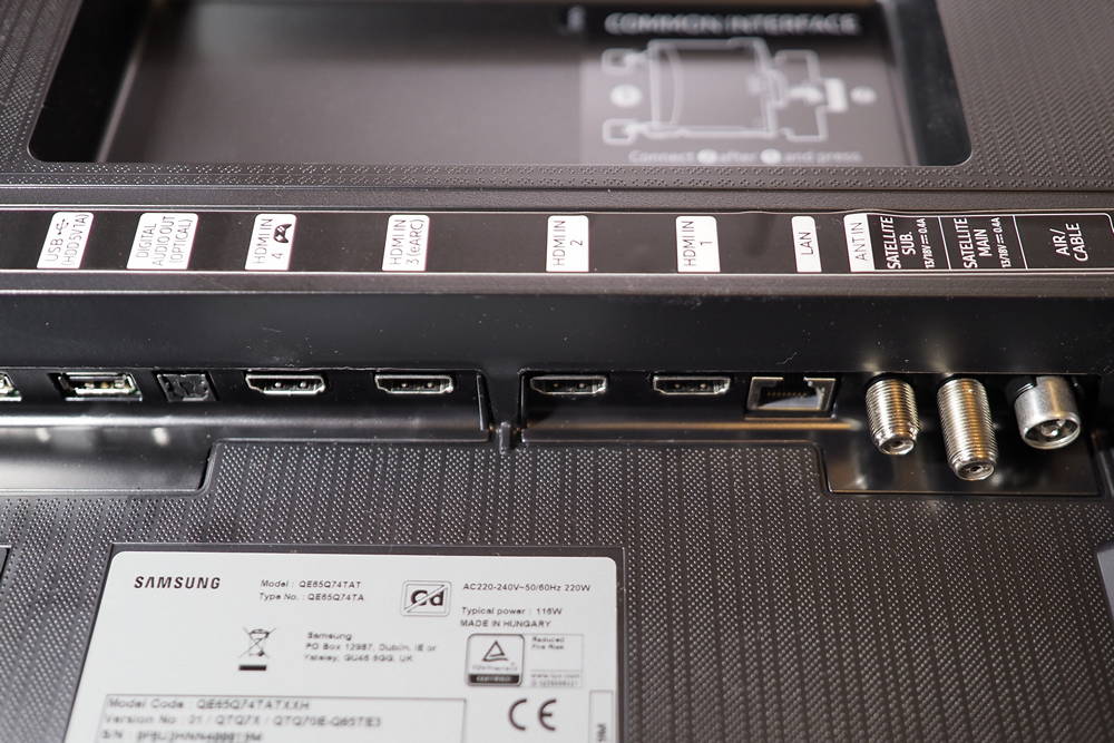

65"...[geex.x-kom.pl]...Samsung QE65Q74TA (QE65Q70T) test...https://geex.x-kom.pl/recenzje/samsung-qe65q74ta-test-i-recenzja-telewizora-granicznego/
QE65Q74TA: panel from service menu 65A1AU7RT, which is of Samsung Display,
-hardware-panel version No. 1 (Version No. 01).
-the remote control is metal. And it is how the QE Q74T series differs from the "ordinary" QE Q70T (the one with the plastic remote control).
-The color temperature of white in film mode was 7496K, so it was almost 1000 Kelvin higher than normal.
-I recommend to change the shadow details option from "0" to "3" because the black level is set incorrectly.
-When it comes to luminance, the TV was clearly brighter than 55Q64T, because in full-screen mode I measured the following values:
maximum: 557 cd / m ^ 2 (50/50),
by default 254 cd / m ^ 2 (32/50),
minimum: 19 cd / m ^ 2 (0/50).
The recommended brightness level for SDR home theater (approx. 120 cd / m ^ 2) ensures that the brightness setting is 15/50.
-In HDR mode on the 10% board, the maximum luminance after three minutes of measurement was 556 cd / m ^ 2.

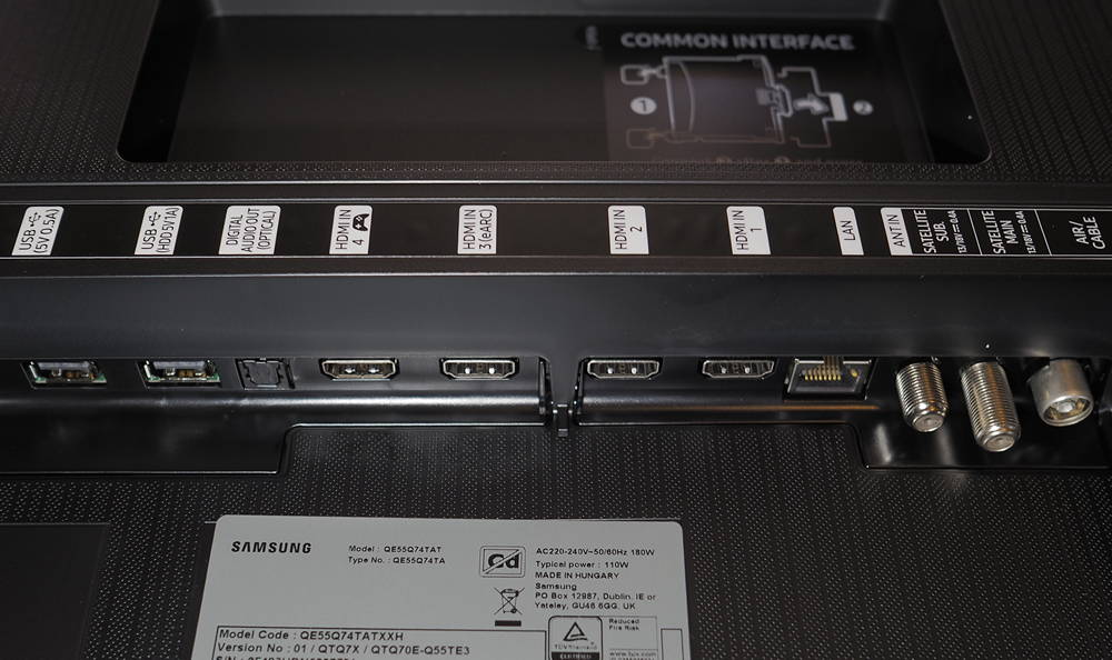

55"...[geex.x-kom.pl]...Samsung QE55Q74TA review...https://geex.x-kom.pl/recenzje/samsung-qe55q74ta-test-i-recenzja-telewizora-4k-z-matryca-120hz/
panel:55A1AU7RT from service menu ,Samsung Display
tested the TV in hardware version No. 1 (Version No: 01).
...When it comes to luminance, the TV was clearly brighter than the 55Q64T, because in full screen mode I measured the following values:
default 223 cd / m ^ 2 (65Q74T: 254 cd / m ^ 2),
maximum: 463 cd / m ^ 2 (65Q74T: 557 cd / m ^ 2).
The recommended brightness level for SDR home theater (approx. 120 cd / m ^ 2) is set to brightness at 17/50.
As you can see, 55Q74T has lower luminance than 65Q74T. This was also confirmed in HDR mode.
In the HDR mode on the 10% board, the maximum luminance after three minutes of measurement was 478 cd / m ^ 2.
