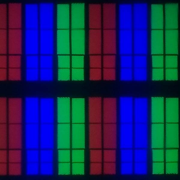

50":VA (Ψευτό-4K. Ανάβουν τα μισά πίξελ σε οποιαδήποτε άλλο τόνο εκτός του λευκού σε video signal.)
43":VA (Ψευτό-4K. Ανάβουν τα μισά πίξελ σε οποιαδήποτε άλλο τόνο εκτός του λευκού σε video signal.)

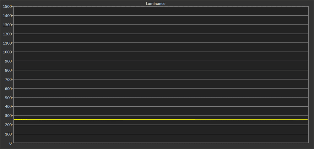

Already in the factory settings, the backlight was set to the maximum (i.e. 50/50), and the measurement showed that in this setting (i.e. to the maximum) on the full screen display the luminance was only 245 cd / m ^ 2.
The screen brightness level suitable for home theater (approx. 120 cd / m ^ 2) sets the brightness option to 28/50.

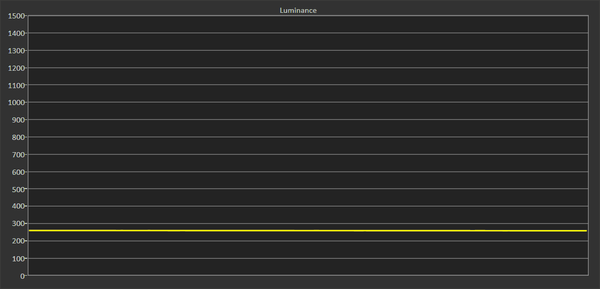

In HDR mode on a 10% board, the maximum luminance after three minutes of measurement was only 253 cd / m ^ 2.
Since the maximum brightness is very low, the Samsung 65TU7102 is well suited to SDR content rather than HDR content. I would like to add that we will notice a significant difference only in the models from the Q6xT series.
