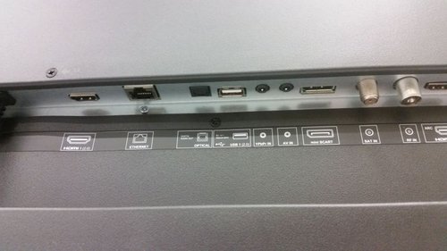

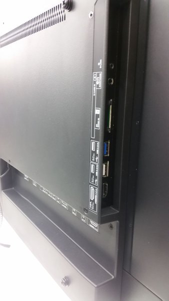

[TD]4 x HDMI2.0 (ARC,CEC,MHL)
2 x USB 2.0
1 x USB 3.0
1 x Satelite in(Main:F-type,female)
1 x AV Composite In 3.5mm jack
1 x AV Component in Mini
1 x Optical Audio Out
1 x 3.5mm Audio Out
1 x Antena (RF) (Female)
1 x CI+1.3
[/TD]
2 x USB 2.0
1 x USB 3.0
1 x 3.5mm Audio Out
1 x CI+1.3
[/TD]

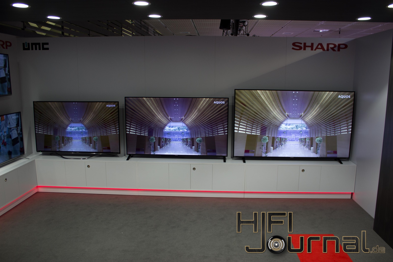

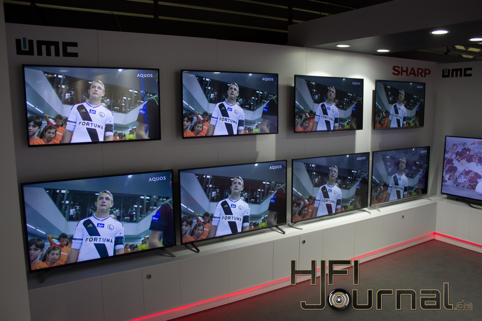

[flatpanelshd.om]...The Sharp TV brand will return to Europe, 50 new TVs announced...http://www.flatpanelshd.com/news.php?subaction=showfull&id=1472982303
...the TVs will not be produced by the Japanese manufacturer but instead UMC of Slovakia who has licensed the Sharp TV brand in Europe...
...The company was recently acquired by taiwanese Foxconn but before that happened the company sold the rights to use the TV brand in Europe to UMC of Slovakia. In the US, the rights were sold to Chinese Hisense...
[hifi-journal.de]...IFA 2016: SHARP Shows new UHD TV line up...http://www.hifi-journal.de/news/24-lcd-fernseher/192-ifa-2016-sharp-zeigt-neues-uhd-tv-lineup
μετάφραση google de to en

[TD]1 x Ethernet RJ45
3 x HDMI 2.0
1 x USB 3.0
2 x USB 2.0
1 x mini SCART
1 x Antena (RF) female
1 x SAT In
1 x CI+ 1.3
1 x SD Card Slot
1 x Mini Component/YPbPr
1 x Mini AV Composite input + Audio In
1 x Audio out / Headphone Jack
1 x Digital Optical Audio Output
