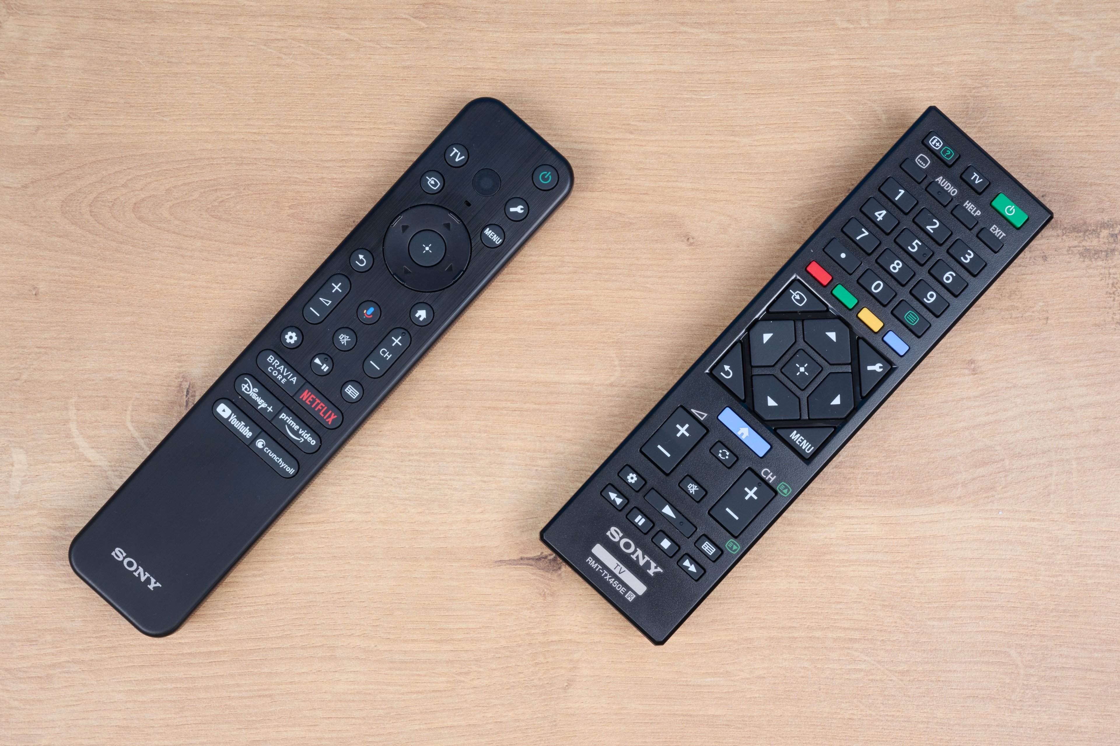

Ήρθε με δύο τηλεχειριστήρια.

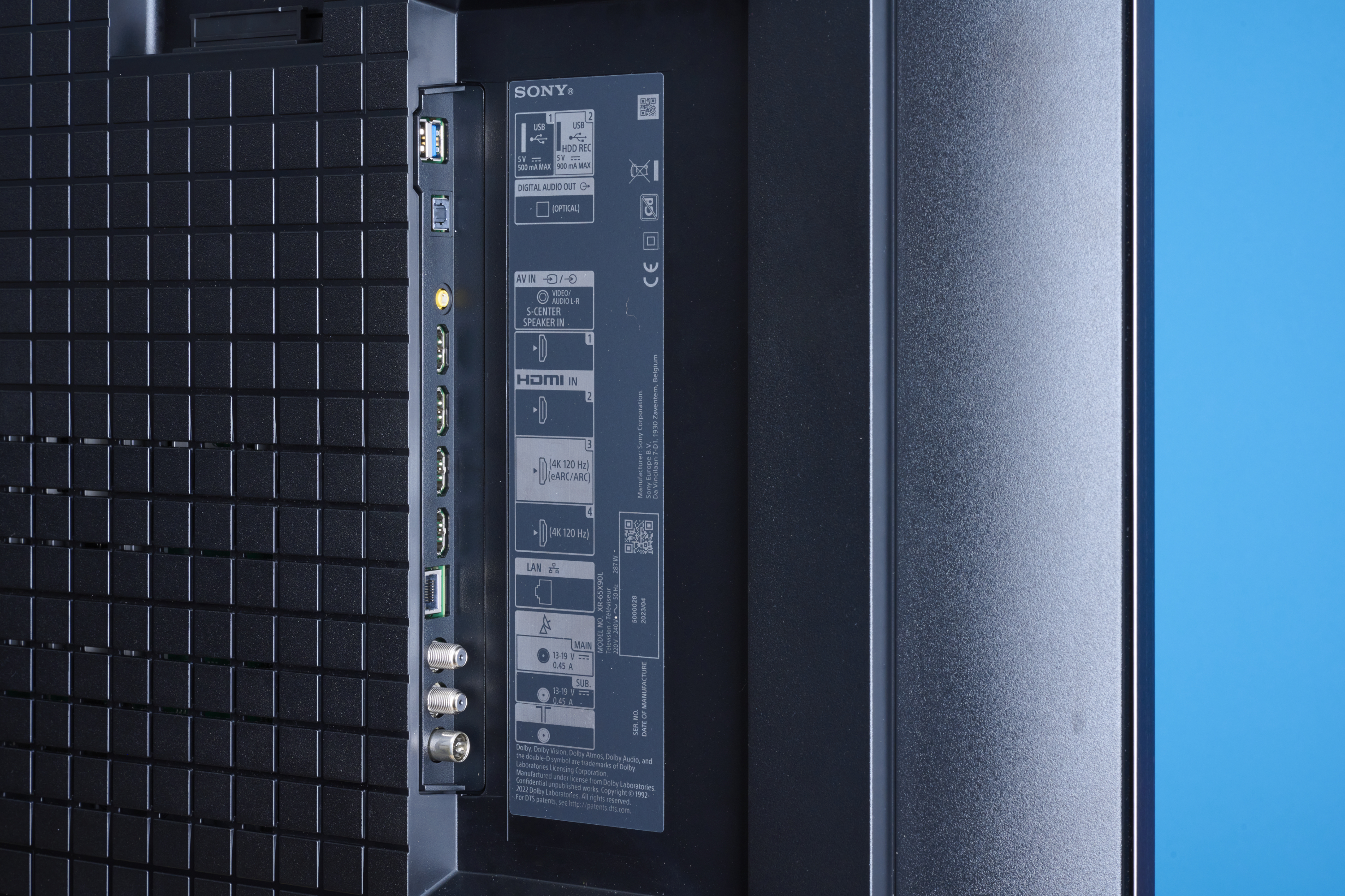

Υποδοχές:
HDMI IN x4 (eARC/ARC port3)
USB x2 : 3.1gen+ usb 2.0
USB drive format support :FAT16/FAT32/exFAT/NTFS
Digital audio out x1 (optical)
Είσοδος composite-AV/ S-Centre speaker in x1 (mini-jack υποδοχή),adapter not included
Έξοδος ακουστικών : όχι
Ethernet (LAN) x1: 10BASE-T/100BASE-TX,solution: USB to Gigabit Ethernet Network Adapter.

2 Remote controls : RMT-TX450E iR and RMF-TX810U bluetooth.

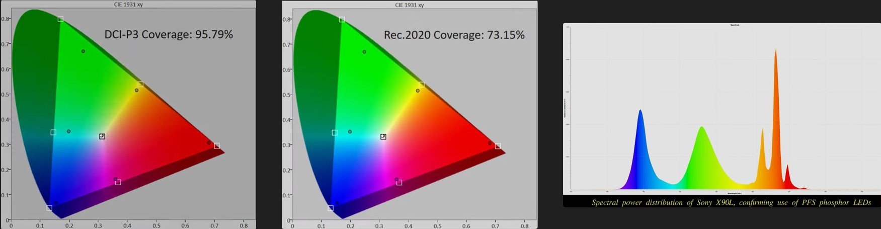

HDR:
Peak brightness on our sample measured 1250 nits on a 10 window after calibration to D65 White point and 680 nits full field
DCI-P3uv color gamut coverage reached 96%.
...The local dimming would be deactivated under the hood whenever the UI (User Interface) was on screen leading to grayish blacks and visible
backlight uniformity on the Google TV home screen and during the loading sequences of streaming apps.
Don't worry this is normal behavior for Sony LED LCD TVs and the local dimming function would be restored once you start playing the actual content on screen...
...If you want:
1) inky blacks,
2) picture accuracy
3) and no blooming
whatsoever all at the same time your only choice is a self-immissive display (OLED) which is capable of pixel level like control .
XR-65X90L DCI-P3 & Rec2020 & SPD color coverage
