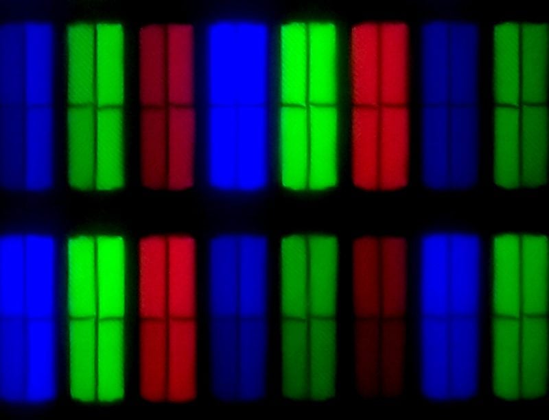

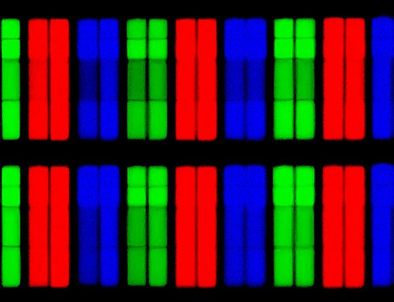

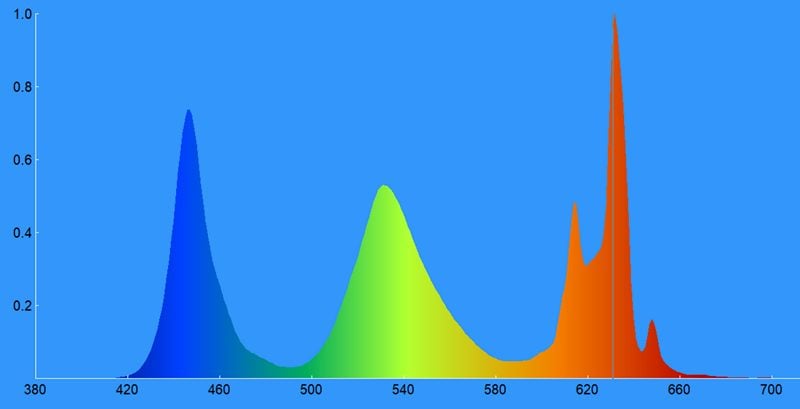

Reviews-test:
65"...[geex.x-kom.pl]...TCL 65C635 review...https://geex.x-kom.pl/recenzje/test-i-recenzja-tcl-65c635/
55"...[dday.it]...TCL 55C635 review...https://www.dday.it/redazione/43264/recensione-tv-tcl-c635-google-tv-qled-prova-review
VA panel
50/60 Hz panel
HDR : maximum value of 384 nits
86% of the color volume of the DCI-P3 space
55"...[chip.pl]...TCL 55C635 test...https://www.chip.pl/2022/06/tcl-c635-test-recenzja-telewizor-2022/
55"...[rtvmaniak.pl]...TCL 55C635 review....https://www.rtvmaniak.pl/9617878/tcl-c635-test/
55"...[geex.x-kom.pl]...TCL 55C635 review...https://geex.x-kom.pl/recenzje/test-i-recenzja-tcl-55c635/
αρχική ενδεικτική τιμή στην ελληνική αγορά 699€.
VA panel,RGB,vertical stripe: ANSI contrast ratio 5146:1
Direct LED LCD
50/60Hz panel
DCI-P3 (CIExy) space coverage : 90%
As in the 43-inch model, a hybrid method was used to convert blue light from the backlight.
The conversion to green is mainly carried out by quantum dots, and the conversion to red is performed by TriGain phosphorus (PFS/KSF).
This means that the 55C635 is not a typical, "full" QLED, but at most a "half-QLED", because it does not use two types of quantum dots, as in typical QLEDs.
This is not surprising and new in this class – competing Dual LED TVs also use "monochromatic" quantum dots to reduce costs.
55"...[clubic.com]...TCL 55C635 review...https://www.clubic.com/television-t...leviseur-abordable-qui-marque-des-points.html
55"...[on-mag.fr]...TCL 55C635 review...https://on-mag.fr/index.php/video-h...i-se-tient-meme-si-la-luminosite-reste-faible
50"...[geex.x-kom.pl]...TCL 50C635 review...https://geex.x-kom.pl/recenzje/test-i-recenzja-tcl-50c635/
VA panel.4-domain,vertical stripe,RGB:ANSI contrast ratio 4746:1
direct backlighting
UHDA-P3 (CIExy) space coverage : 90%
In HDR mode on the 10% board, the maximum luminance after three minutes of measurement was 410 cd / m² (nits).
50/60Hz panel
This means that the 55C635 is not a typical, "full" QLED, but at most a "half-QLED", because it does not use two types of quantum dots, as in typical QLEDs. This is not surprising and new in this class – competing Dual LED TVs also use "monochrome" quantum dots to reduce costs.
Suitability of the TV:
TV: 5/10
Home cinema: 5/10
Sports: 2/10
Games: 2/10
43"...[geex.x-kom.pl]...TCL 43C635 review...https://geex.x-kom.pl/recenzje/test-i-recenzja-telewizora-tcl-43c635/
VA panel
Direct LED LCD
50/60Hz panel
SPD
This means that 43C635 is not a typical, "full" QLED, but at most a "semi-QLED", because it does not use both green and red quantum dots, as in typical QLEDs.
This is not surprising and new in this class – after all, competing Dual LED TVs also use "mono-chromatic" quantum dots to reduce costs.
