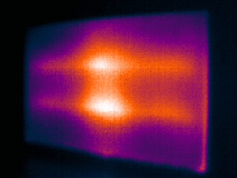

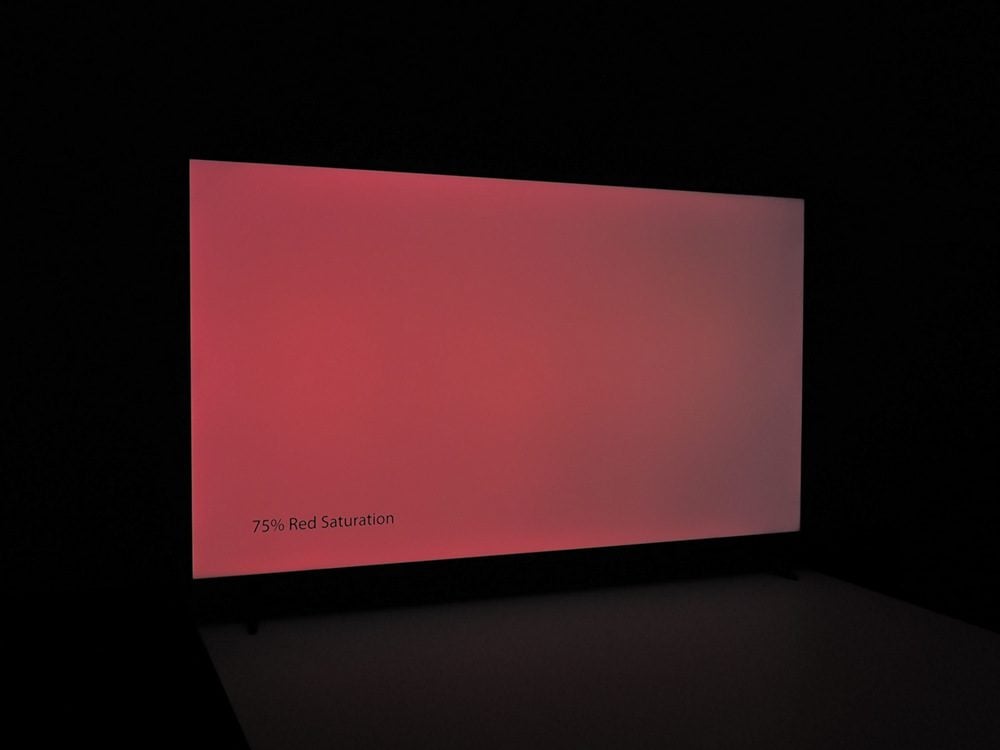

VA panel: ANSI contrast ratio 5200:1
HDR content: In Movie mode, on a 10% board occupying 10% of the screen, the maximum luminance was 244 cd/m² (nits.

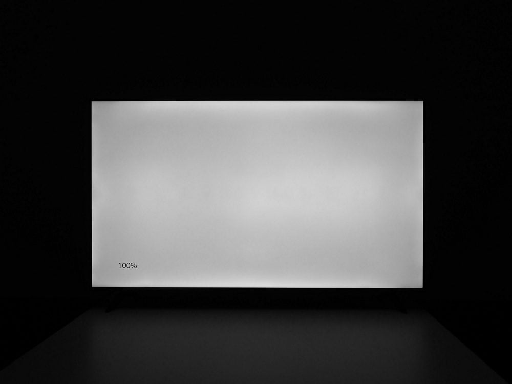

direct illumination with two horizontal rows of LEDs
50"...[geex.x-kom.pl]...TCL 50V6B (50V6BX1) review...https://geex.x-kom.pl/recenzje/recenzja-tcl-50v6b/
direct illumination is used with only one horizontal row of LEDs

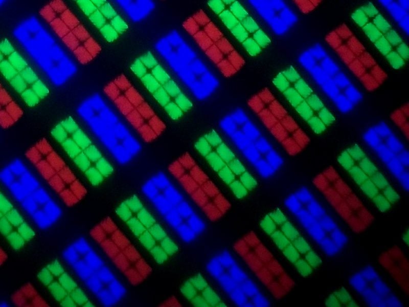

only able to display the standard color gamut,SDR
DCI-P3 (CIExy) coverage : 80%
HDR : In film mode, the maximum luminance on a board occupying 10% of the screen area was 215nits

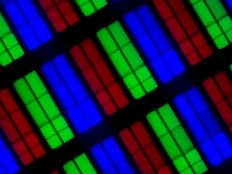

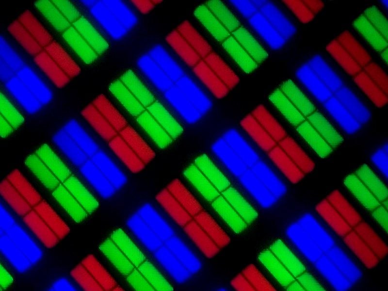

VA panel RGB,vertical stripe : ANSI contrast ratio 5158:1

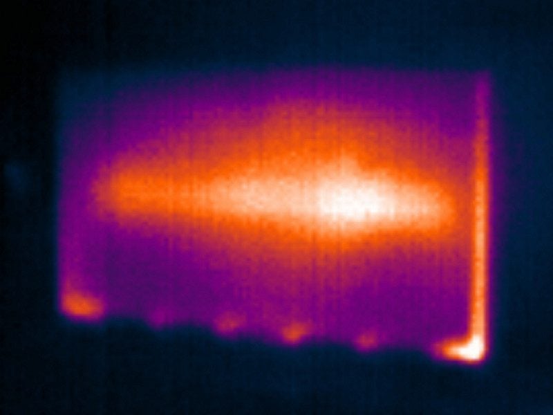

Direct LED...It seems that a centrally placed single row of LEDs was used..

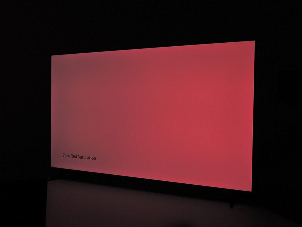

...Vertically, the degradation is greater than in the horizontal one..
