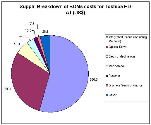

Is Toshiba hoping to buy a head start in the battle for the next generation of DVD technology? The answer is yes, according to market research firm iSuppli, which recently dissected Toshiba's new HD-A1 HD DVD player and priced all of its components.
According to iSuppli's teardown analysis, the bill of materials (BOM) cost for the HD-A1 exceeds its US$499 retail price. The HD-A1's estimated US$674 BOM figure excludes costs for manufacturing, testing, cables, remote control and packaging. Those additional costs could easily push the total cost of the HD-A1 to more than US$700 per unit.
The finding suggests that Toshiba is subsidizing the HD-A1 in an attempt to gain early market share over players that use the rival Blu-ray high-definition (HD) DVD standard. Initial Blu-ray players are scheduled for launch by Samsung Electronics, Sony and others this summer. These products will have retail prices starting at US$999.
Like many early models, the HD-A1 does not have an especially efficient design.
"The Toshiba HD-A1 is basically a combination of a low-end PC and a high-end DVD player," noted Andrew Rassweiler, teardown services manager and senior analyst for iSuppli.
Moreover, the HD-A1 utilizes a general-purpose microprocessor instead of more cost-effective application specific standard product (ASSP) semiconductors typically used in consumer electronics products. The HD-A1 employs an Intel Pentium 4 as the main microprocessor, as well as Broadcom's BCM7411 for HD video decoding and four ADSP-2126x SHARC programmable digital signal processors (DSPs) from Analog Devices.
The total estimated cost of these semiconductors is US$137.
The HD-A1 also uses US$125 worth of memory, including a 1GB dual inline memory module (DIMM) from Hynix Semiconductor., three other types of DRAM, a 256MB flash memory disk from M-Systems and 32MB of MirrorBit flash memory from Spansion.
Adding in other chips brings the total integrated circuit (IC) cost of the HD-A1 to about US$247 per unit.
