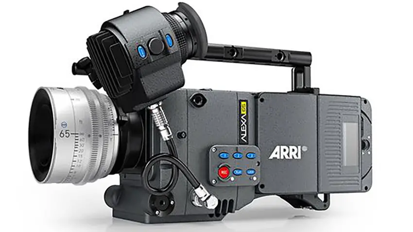

The commonly used cameras today include the Arri Alexa 65, Alexa LF and Alexa LF Mini; Canon C500 MKII and C700 FF; Panavision DLX2; Sony Venice; and Red Monstro VV.
