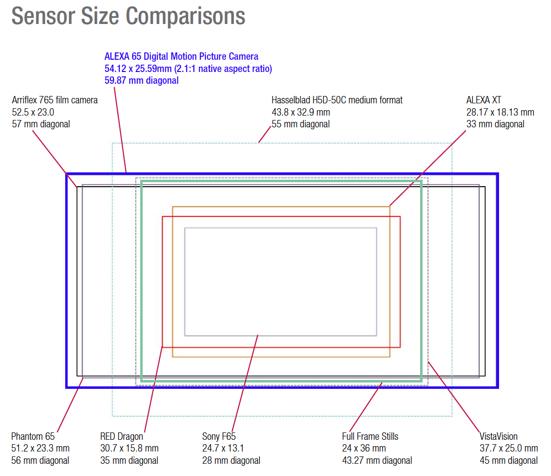

This means that we have cinema Super 35mm at 18mm x 24mm, roughly; “full format” at 24mm x 36mm; 70mm at 52.5mm x 23mm; and the largest cinema format ever commercially produced, Imax, at 51.638mm x 70.739mm — none of which even come close to the largest medium format still film, let alone large format.

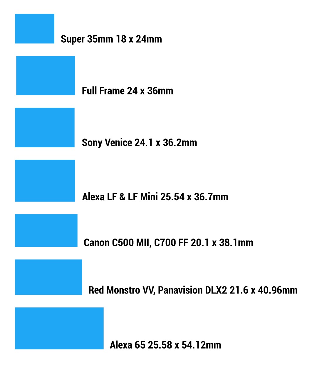

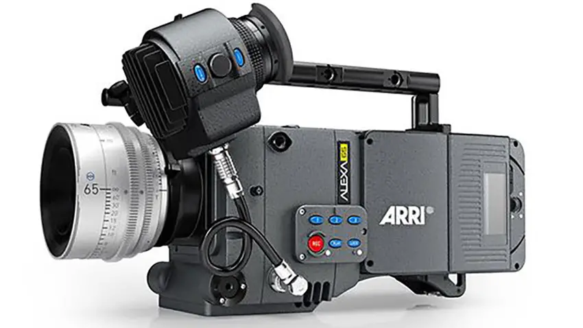

The commonly used cameras today include the Arri Alexa 65, Alexa LF and Alexa LF Mini; Canon C500 MKII and C700 FF; Panavision DLX2; Sony Venice; and Red Monstro VV.

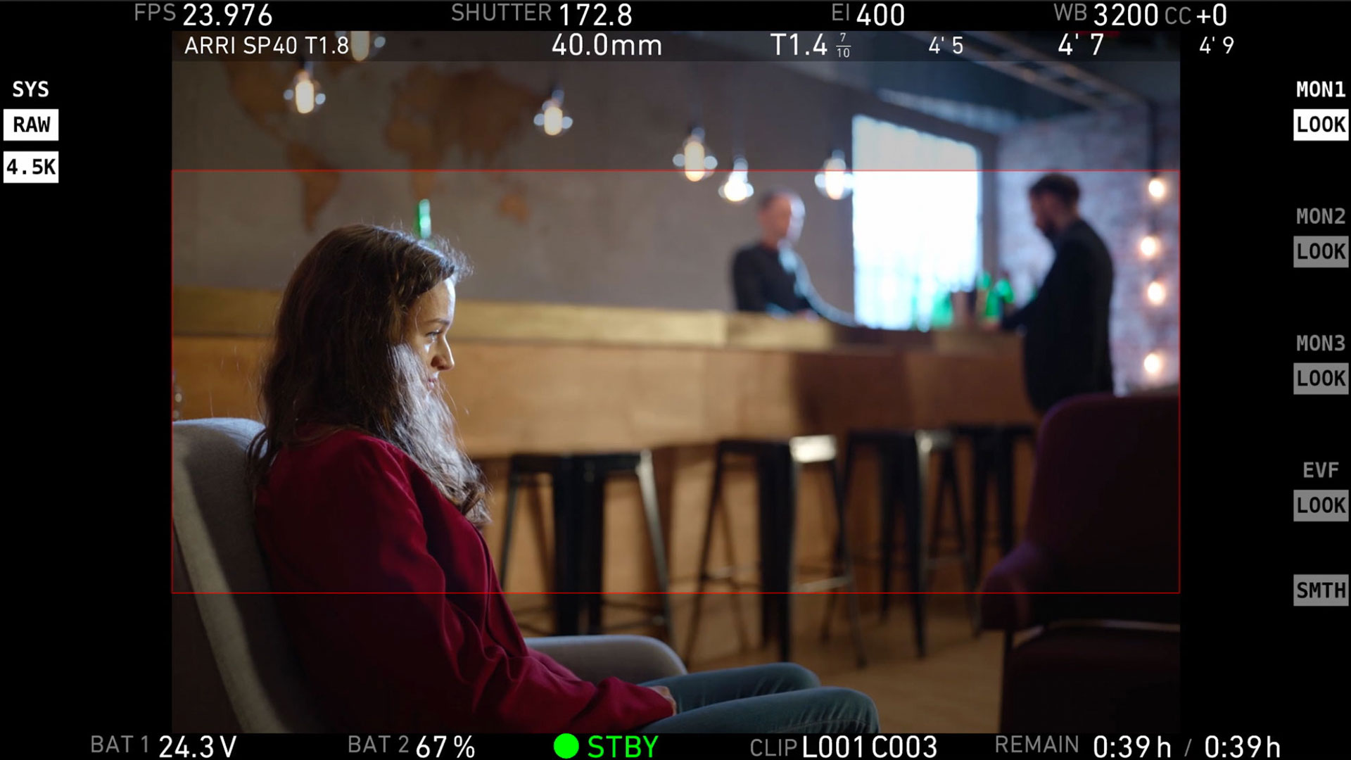

The difference in depth of field when matching field of view with two different lenses: a 35mm on the Mini and a 70mm on the 65, both at a T2.8.

A comparison of sensor sizes. (Image courtesy of Jay Holben)
