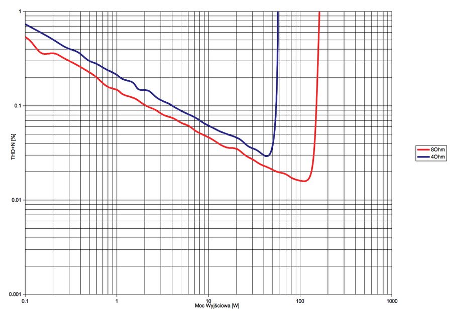

AVR-X4400H
Manufacturers of receivers like to boast of high output power. This is also the case with the AVR-X4400H, which is to have as much as 200 W, but this applies to the situation of controlling one channel at a load of 6 Ω.
In our measurements, we assume the basic 8-ohm load, in such conditions the AVR-X4400H also achieves a high 162W. When two channels are controlled, it provides 2 x 154 W, five-channel mode up to 5 x 99 W, and with all nine terminals - 9 x 50 W, also reaching a high temperature, so you should not set anything on the AVR-X4400H.
It is also possible to load 4 ohms, in all channels, but for this purpose it is recommended to select such mode in the impedance selector. The power then drops radically - even if one channel is actuated, it is only 57 W. This is due to the very protective configuration of the terminals, which protects against temperature rise. Because it leaves a large reserve in the power supply itself (common for all terminals), so with the connection of further terminals, the power decreases slightly, by 5 x 51 W to 9 x 42 W.
The noise (S / N) spacing is 80 dB and the 101 dB dynamics are not sensational but typical for A / V receivers. The frequency characteristics (Fig.1) are very good, the decrease at 100 kHz is -1.6 dB for 8 Ω and -2.3 dB for 4 Ω. The harmonic spectrum (Figure 2) also looks elegant, none exceeds the ceiling of -90 dB.
Α, καλά..τι να οδηγήσουν αυτοί..μα να δίνει λιγότερα watt στα 4Ohm από ότι στα 8;
Μπορούν και οι δυο αν κι εφ' όσον γυρίσεις το selector στα 4Ω για να μην έχεις θέματα με τη θερμική προστασία. Αλλά σε αυτήν την περίπτωση όπως βλέπεις και οι δυο έχουν στάνταρ ισχύ, ο Marantz στα 68W και ο Denon στα 57W.
Μια διαφορά είναι αυτή ανάμεσα στις δυο αυτές μάρκες, όπου συνήθως οι Marantz τα πάνε καλύτερα overall. Η άλλη διαφορά είναι η προενίσχυση όπου η Marantz χρησιμοποιεί HDAM ενώ η Denon όχι. Για να σου απαντηθεί η απορία γιατί τα Marantz είναι λίγο πιο ακριβά από τα Denon, ενώ φαινομενικά είναι πανομοιότυπα. Δεν είναι ακριβώς.
Ζητάς πολλά από τα τροφοδοτικά των ενισχυτών AV. Όταν ο αριθμός των καναλιών παίρνει την ανηφόρα και το τροφοδοτικό είναι ένα... θα έχεις αναμενόμενη πτώση ισχύος. Βέβαια στην πραγματικότητα είναι σπάνιο να ζητηθεί ισχύς ταυτόχρονα σε όλα τα κανάλια.

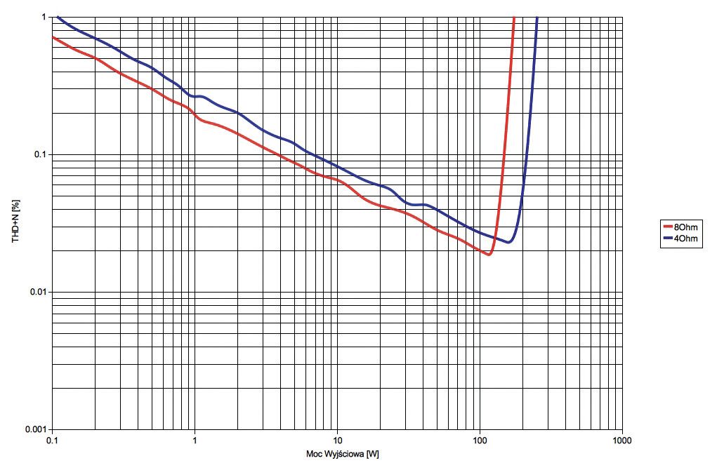

Πάρε και του SR5011 τη μέτρηση:
Although Marantz does not specify 4 Ω of power in the specification, it does not warn against connecting such speakers.
The power for the control of one channel is 144 W and 191 for 8 and 4 Ω respectively, in stereo 2 x 131 W and 2 x 162 W. Despite the expected drop in the multi-channel configuration, with five pilot channels simultaneously still high 5 x 69 W and 5 x 81 W; this time, no protections were interfering with the measurements, and all this with sensitivity perfectly compatible with the 0.2V standard.
A 78 dB noise gap is no longer impressive, the dynamics are stopped at the 99 dB ceiling.
The frequency response (Fig.1) does not reveal any problems, the harmonic spectrum (Fig. 2) is exceptionally clean, none even approaches the level of -90 dB (the strongest - the third - lies at -96 dB). Distortion THD + N (figure 3) with a value lower than 0,1% can be obtained for an output power exceeding approx. 4 W at 8 Ω and 7 W at 4 Ω.
