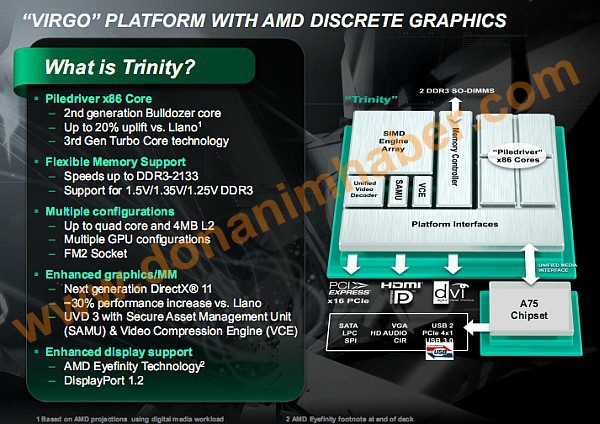

Μπερδεμένα τα πράγματα για το επόμενο "μεγάλο" Fusion APU... To ονομαζόμενο Trinity. Άλλο socket (FM2), αλλά συμβατό με το ήδη υπάρχον Α75 chipset...
http://hexus.net/tech/news/cpu/32335-new-amd-trinity-apu-information-emerges/
While we know that Trinity APUs will be crafted for AMD's FM2 socket, it seems that the current A75 chipset will be compatible with the next-gen offerings. AMD's also talking-up a 20 per cent performance increase, compared to its current Llano APUs. On the graphics front, there's also a claimed performance boost of up to 30 per cent.
What Trinity is also set to bring to the table, is support for RAM speeds up to DDR3-2,133MHz - at voltage levels ranging from 1.25V up to 1.5V.
Based on the chip manufacturer's Piledriver architecture, Trinity is said to serve-up third-gen Turbo Core technology, AMD Eyefinity, and DisplayPort 1.2 support.
Image Source: DonanimHaber
(τα bold δικά μου)

Those are the differences in a nutshell. Husky core is based on upgraded 10h microarchitecture (also known as AMD K10), the same microarchitecture that is used in Phenom II CPUs. As for Piledriver, AMD is referring to it as second generation Bulldozer core (see our Bulldozer review). Trinity will have up to four cores, just like Llano, which means up to two Piledriver modules (each Bulldozer/Piledriver module has two cores). In terms of speed, AMD is claiming up to 20% increase over Llano. Bulldozer's poor single-threaded performance might cause the performance upgrades to be limited to multithreaded tasks though, unless AMD can do magics with Piledriver (aka 2nd gen Bulldozer). RAM support is also up from DDR3-1866 to up to DDR-2133.
GPU department will also get an overhaul. We already reported that Trinity's GPU will be named as AMD 7000 Series, which suggests that it will be based on the same design as other 7000 Series GPUs (this might sound obvious, but Llano's GPU was named as 6000 Series, yet it was based on 5000 Series "Redwood" core). The leaked slide supports this since it mentions support for next generation DirectX 11, most likely DX 11.1. AMD will also compete with Intel's QuickSync by including Video Compression Engine (VCE) in Trinity. Performance increase will be around 30% compared to Llano's GPU according to AMD.
Trinity will continue to use the same chipsets as Llano. However, the socket will change to FM2, which will most likely be compatible with FM1. Another leaked slide shows that mobile Trinity's package is FS1r2, whereas Llano's is FS1. The APU after Trinity, called Kaveri, will use FS2 package. This suggests that FS1 and FS1r2, as well as FM1 and FM2, are very similar and hence backwards compatible. This has not been confirmed though.
Availability is unknown but if roadmaps are to believe, Trinity should make its first appearance in Q1'12, full availability being in Q2'12.

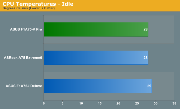

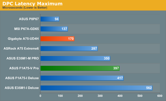

ASUS F1A75-V Pro vs. Gigabyte GA-A75-UD4H – Llano at ~$120

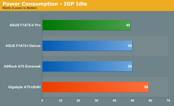

Power Consumption
Power consumption was tested on the system as a whole with a wall meter connected to the power supply, while in various configurations. This method allows us to compare the power management of the UEFI and the board to supply components with power under load, and includes typical PSU losses due to efficiency. These are the real world values that consumers may expect from a typical system (minus the monitor) using this motherboard.

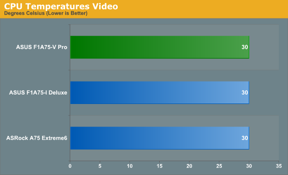

CPU Temperatures
With most users’ running boards on purely default BIOS settings, we are running at default settings for the CPU temperature tests. This is, in our outward view, an indication of how well (or how adventurous) the vendor has their BIOS configured on automatic settings. With a certain number of vendors not making CPU voltage, turbo voltage or LLC options configurable to the end user, which would directly affect power consumption and CPU temperatures at various usage levels, we find the test appropriate for the majority of cases. This does conflict somewhat with some vendors' methodology of providing a list of 'suggested' settings for reviewers to use. But unless those settings are being implemented automatically for the end user, all these settings do for us it attempt to skew the results, and thus provide an unbalanced 'out of the box' result list to the readers who will rely on those default settings to make a judgment.

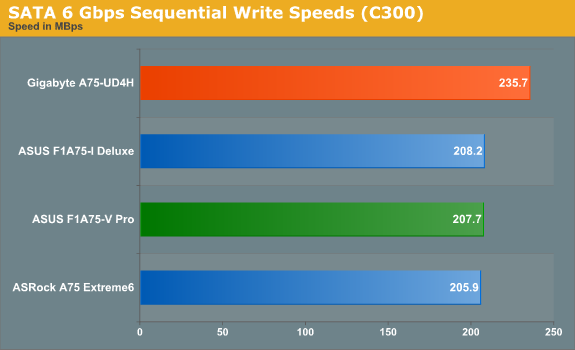

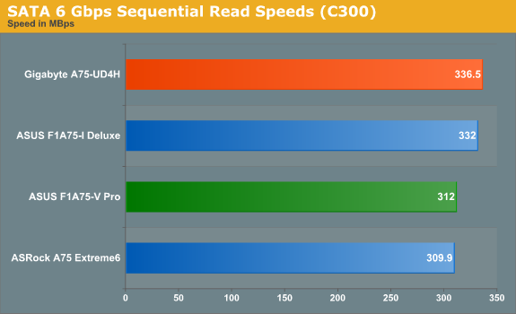

SATA Testing
We also use CrystalDiskMark for SATA port testing. This test probes the efficiency of the data delivery system between the chipset and the drive, or in the case of additional SATA ports provided by a third party controller, the efficiency between the controller, the chipset and the drive.
DPC Latency
Both ASUS and Gigabyte are well known for their large ranges of motherboards in all chipsets—ASUS tends to go from the standard to Pro, Evo, Deluxe, TUF and ROG, whereas Gigabyte usually from the UD2 to the UD5/7/9, both depending on the enthusiast level of the chipset. Both the A75-UD4H and F1A75-V Pro here are near the top end for A75 and Llano, being fully featured ATX boards, and only the mini-ITX A75 boards cost substantially more.
ASUS F1A75-V Pro
Overall, there is not a lot wrong with this ASUS board. The benchmarks on a whole perform relatively well with one exception, DPC Latency, but it falls within recommended levels as long as the AI Suite software is not running.
The ASUS uses all six SATA 6 Gbps from the FCH internally, as well as another from an ASMedia controller. Unfortunately, this other SATA 6 from the controller gets blocked by a full length GPU. In terms of layout, the second PCIe x16 is actually limited to x4, giving any dual-GPU CrossFireX users a bottleneck in certain scenarios.
The fan control software is some of the best we have seen, and the BIOS is top notch in terms of usability and features. This is all wrapped in a three year warranty, and the board is available for under $120.
There are arguably more concerns with the Gigabyte board in our tests, initially resulting in memory issues with our kits of memory. With the Gigabyte board you do not get a graphical BIOS implementation, any serious fan control, or auto overclock options; it also has fewer SATA ports, but there is a Firewire port, a TPM header, and x8/x8 support for dual discrete GPU systems (despite this being an APU platform).
Over our whole range of graphics tests, the Gigabyte, on average, does not perform as well as the ASUS board, but on our CPU tests it does edge ahead in almost all areas, except the video transcoding test.
The Gigabyte board does sport their DualBIOS technology in case of BIOS corruption, and they had more SATA cables included in the media sample I was sent. As with the ASUS board, Gigabyte gives their product a three year warranty.

When talking about motherboards in this price range, there is usually very little to separate them in terms of hardware. One or the other may sport a single different controller, or use different implementations to get better results. Ultimately, each of the ASUS and Gigabyte boards, inter alia, has their pros and cons:
ASUS F1A75-V ProGigabyte GA-A75-UD4H
PCIe Lanesx16/x4x8/x8
Dual BIOSNoYes
Firewire HeaderNoYes
Better DPC Latency397170
Better OC ResultsNoYes
Auto CPU OC OptionsYesNo
Better Fan ControlsYesNo
Graphical BIOSYesNo
