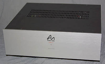

In other words, the Audio Note™ DAC 5 Special has no over sampling, no jitter reduction, no noise shaping and no re-clocking, it uses the highest grade Analogue Devices AD1865, 18Bit stereo converter chip because we found this chip to be the best sounding available (yes, even better than the 20Bit versions!!), the digital power supply is an exceptionally low noise, shunt-type. Having removed all the digital filtering that is part of the over sampling, all filtering in the DAC 5 Signature is done in the analogue domain where is appears to be easier to retain good wide band phase-frequency and dynamically coherent behaviour than in the digital domain."
Of course like all top end products from Audio Note, there are many filter-interface coils/transformers wound with their pure silver wire and extremely high content nickel mu-metal cores. As you can see above there are a total of twelve coils/transformers. Top-grade Elna power capacitors are used for the main power supply (center) while the tubed analog boards (bottom left) use very expensive high-quality Black Gate capacitors. The usual bit and pieces (or at least usual for a top-range Audio Note product) grace the remainder of the unit. This, plus a very sturdy case brings us to a weight of 22 kilograms (almost 50 lbs.)! Most multi-bit Japanese CD players weigh in at around two pounds total. Make of that as you will.
In contrast, the top rig DAC5 Signature ($55,000) is all silver, has "better" Black Gates, silver wire everywhere, plus an improved power supply and Audio Note carbon resistors plus the silver wires super interface. Back to our story...
The DAC 5 Special analog section employs an upgraded M6 Line pre-amplifier output stage with two anode followers after another using a single 5687 double triode per channel. Of course this is coupled to an output transformer, though this time one with copper wire on a High B C-core which they claim is equivalent to the quality of the cores in my previously owned Ongaku! Alas, the Ongaku now resides in someone else's home as my personal finances took a nose dive a few years back. i miss it greatly. Anyway...

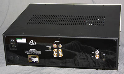

Analog outputs appearing on the rear of the unit include both unbalanced "single ended" (RCA) and balanced (XLR and LEMO) operation. My review sample as seen above included two sets of female RCA jacks and one pair of LEMO for analog output as appear on the rear, center of the unit. To the right are the digital inputs that include both RCA and BNC jacks. The balanced output via the LEMO connectors is truly symmetrical via the usage of an inter stage transformer which is symmetrically wound to provide symmetry of the positive and negative waveforms of the signal at all amplitudes (signal levels) but also provide wide band impedance conversion.
There is no provisions for the considered less than optimum TOSlink or better AT+T glass fibre. A separate ground post on the far right is for those looking to unify their grounding scheme. On the top left is the power on/off switch with a standard IEC power jack plus two fuse holders below it.
