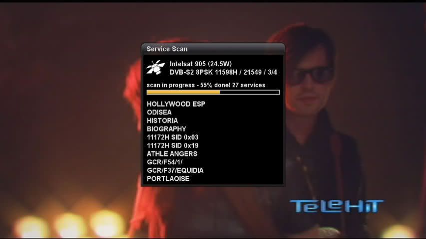

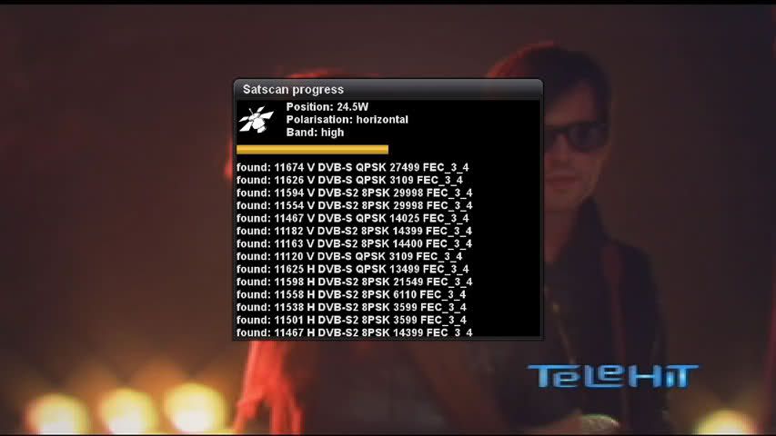

Satscan (Blindscan) [Me/MiniMe]​
Open AZBox MOD
Satscan (Blindscan) for Me and MiniMe.
To activate it please download directly from Plugins in Open AZBox MOD (Me, MiniMe) by this way:
menu --> plugins --> download plugins (green button) --> systemplugins --> satscan (v1) - BlindScan for AZBox Receivers
After download is done, please download file attached to this post (lib.rar), and transfer driver avl2108.ko to /lib/modules/3.3.1-opensat/extra/
After that reboot receiver, and You are ready to use Satscan (Blindscan) on Me and MiniMe.
Soon it will be available on GIT too.
We send pull request to e2openplugins with changes for Satscan, as they maintain it.
