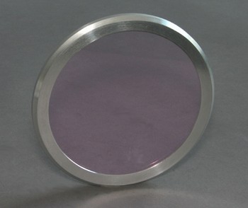

...Like its predecessor TW4400/5500, the image display becomes light green with maximum utilization of the light; especially in face the colors will lose their naturalness. A subsequent calibration without optical correction proves to be very difficult to impossible. But help created an additional filter that comes with the Light Power Edition and can be plugged onto the lens.
Special light power filter of the 9000 series​
Such filters were already in the Light Power Editions of the 4400/5500 series, but in the case of the EH-TW9000 is a bit larger and very impressive: since the filter is no longer plugged directly onto the lens (because of the dust cover) but on the chassis ring surrounding the lens, it has a diameter of about 12 cm, which is larger than a CD! Accordingly, the screwing ring is aluminum. A pleasant side effect: The filter acts as an additional dust shield, so that the lens is spared of the irritating grains when in operation...
Πηγή: cine4home.de review (απόδοση στα αγγλικά με τη βοήθεια online μεταφραστών)
Η έκδοση του προβολέα με το φίλτρο λέγεται Light Power Edition και θα βγει μόνο στη Γερμανία κι ακόμα 2 ευρωπαϊκές χώρες (ούτε στην Αμερική).
