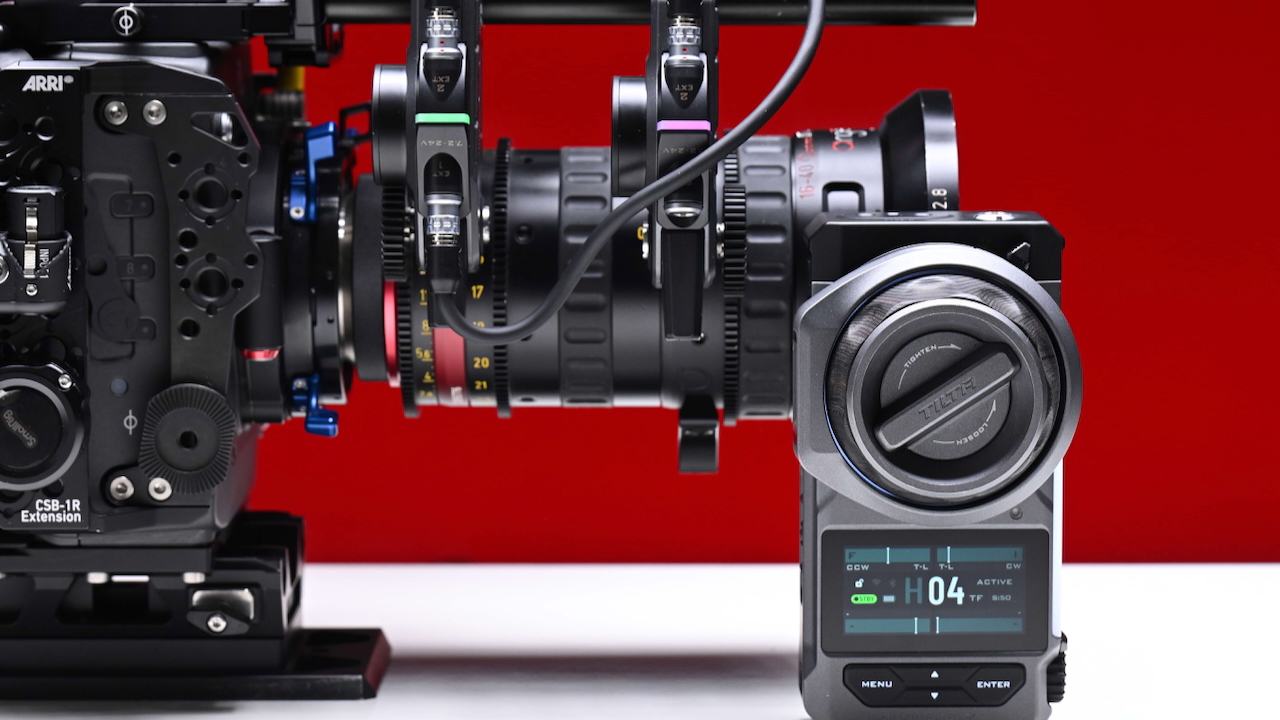

The new Tilta Nucleus-M II is a follow-up to the original Nucleus-M. Tilta introduced the Nucleus-M way back at NAB in 2017. It was designed to be an affordable FIZ system for the masses and at $1,199 USD it was considerably more affordable than anything else on the market at the time. It took...
Core Upgrades
- Compatible with First Generation’s Ecosystem– Seamless integration of the focus ring, data interface, and lens control motor—no need to replace your existing gear.
- Built on a Classic Design- Retains the damping adjustment and shortcut layout for easy operation—zero learning curve for existing users.
- New Electronic Focus Ring Added– Featuring a detachable design that preserves first-gen physical focus ring markings. Mark manually when removed, or switch to on-screen digital markings when attached.
- 2.4-inch Touchscreen Display– Quick access to focus, aperture, ISO, etc. with instant on-screen controls.
- Upgraded PID 2.0 algorithm and motor optimization for the Nucleus M II lens control motor—0.02s fast response and ultra-smooth focus adjustments, which are claimed to be free from stutter and delay.
- Four-way Multi-channel Series Connection– Directly control the Nucleus-M II lens control motor with the hand wheel, supporting up to 4 channels in series.
- Replaceable Gears– Modular design for quick assembly and long-term maintenance.
- Compatible with Multiple Mounting Rod Options– Nucleus-M II includes 15mm and 19mm rod adapters
- Nucleus-M II Wireless Control Handle– Versatile control system with seamless switching between primary and secondary functions.
- Compatible with NP-F Batteries– Powered by NP-F550 batteries.
- Supports Storage of up to 128 Lens Data Presets– The Nucleus-M II hand unit features built-in data storage, allowing one-touch access to saved settings for fast and convenient adjustments.
- MARK Point & RANGE Memory– Power loss protection keeps your settings intact, even after a power outage.
- Nucleus-M II Left Hand Mode– Customizable hand wheel position for all users.
- Robust Anti-Interference with Four Independent Channels– Upgraded channels for stronger signal, stable transmission, and precise focus.
- Modular Hand Unit with Zoom Modules– Customizable mounting on either side of the wireless control handle. Accommodate both left and right-hand users.
