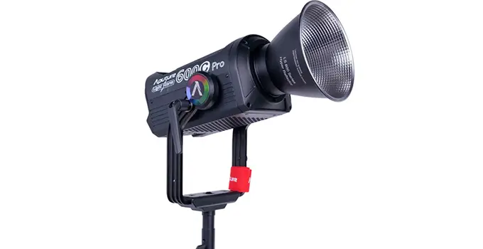

Mολις ανακοινωθηκε.
Νεα εκδοση για το daylight 600αρι πιο ελαφρυ
  • Comparable to a 1200W HMI or Joker 800
  • 0-100% Brightness Control in 1% Step Increments
  • CRI ≥96, TLCI ≥96, SSI (D56): 72
  • Multiple Control Methods: 2.4GHz Remote, Sidus Link
  • Bluetooth App Control, 5-Pin DMX512 In & Out
  • Can Achieve Half Output with 2x V-Mount / Gold Mount Batteries (14.4V/15A, 26V/8.5A, 28.8V/7.5A)
  • Supports 48V DC Input Power @ 15A, Including Battery Power Stations & Block Batteries (3-Pin XLR)
  • LS 600 Series Hyper Reflector for Increased Output
  • Accepts Bowens Mount Light Modifiers
  • Curved, Handbrake-Locking Yoke with 360° Rotation
  • Dual Junior/Baby Pin (16mm / 28mm | 5/8in / 1.125in)
  • 6m Weatherproof Locking Neutrik Power Cable
  • Built-in Lightning Clamp Quick Release Plate
  • 4 Dimming Curves: Linear, Exponential, Log, S-Curve
  • 8 Built-in Lighting FX: Paparazzi, Fireworks, Lightning, Faulty Bulb, TV, Pulsing, Strobe, & Explosion
The Aputure LS600D is available with either Gold or V mount battery configurations, the Aputure LS600D is available for preorder at $1390. $500 less than the Pro variant.
E ναι αλλα δεν εχει τον ιδιο ογκο. Το κουτι του 600αριου ειναι τερας . Και δεν εχουμε δει ακομα το 1200αρι ποσο θαναι
SPECIFICATIONS:​
Here’s a complete breakdown of the specs:
  • CCT – 2300-10,000K
  • CRI – 95
  • Beam Angle (No Accessories) – 93°
  • LS 600 Series Hyper Reflector – 62°
  • Max Power Output – 600W
  • Lumens – 35,686
  • Operating Voltage (Power Supply) – 100V~240V, 50Hz/60Hz
  • Operating Voltage (Battery) – V-Mount / Gold Mount (Two Batteries) – Half Output 12.5V-16.8V (14.4V/15A) 22V-33.6V (26V/8.5A, 28.8V/7.5A)
  • Operating Voltage (Battery) – V-Mount / Gold Mount (Two Batteries) – Full Output 22V-33.6V (26V/18A, 28.8V/16A)
  • 3-Pin XLR (48V DC)
  • Operating Temperature -20°C ~ 45°C / -4°F ~ 113°F
  • Dimming 0-100%; Linear, Exponential, Logarithmic, S- Curve
  • Control Methods On-board, Sidus Link App, 16-bit DMX512, Art- net & sACN via etherCON, LumenRadio CRMX
  • Wireless Operating Range (Bluetooth) ≤80m; (LumenRadio) ≤100m
  • Screen Type – LCD
  • Cooling Method – Active Cooling
  • Accessory Mount – Bowens Mount
  • Tilt Angle – 360°
  • Estimated LED Lifetime (L70) – 50,000H
  • Est. Max Flicker-Free FPS 2,000 FPS
By keeping performance high and the price lower, Aputure continues to provide high-quality tools for content creators managing a tight budget. And the LS600C Pro looks to be no exception.
PRICING AND AVAILABILITY:​
Expected to ship in the Fall of 2022, the Aputure LS600C Pro is available for pre-order now for $2,490.
