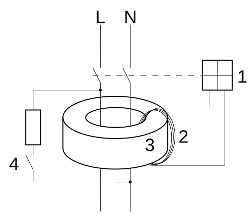

Residual current device (RCD)
1.Electromagnet with help electronics
2.Current transformer secondary winding
3.Transformer core
4.Test push-button
L live conductor
N neutral conductor
Πηγή: Wikipedia
http://en.wikipedia.org/wiki/Residual-current_device
