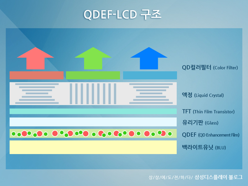

[TD="colspan: 6, align: center"]True Ultra HD (RGB subpixel panel structure) Quantun Dots LCD - Edge led, 10-bits.[/TD]

[TD="bgcolor: #40e0d0"]Models (QDEF)(100/120Hz) with MCFI & BFI:[/TD]
[TD="align: center"]MU9002, MU9000, MU8002,
MU7070, MU7002(55" and bigger).[/TD]
[TD="align: center"]SJ957, SJ955, SJ950, SJ850[/TD]

QDCF
http://cfile4.uf.tistory.com/image/217DC045576A3FC41AB09B
QDEF
http://cfile10.uf.tistory.com/image/2720813E576A3F78120096
https://www.youtube.com/watch?v=nnQmP5seuHE
PFS LED - Potassium fluorosilicate (PFS)-based phosphors for LED-based backlighting in displays.
With colleague xavito, we have a dispute over whether Samsung's MU series, is like the old KS series(2016) and JS(2015) - with quantum dots film.....
