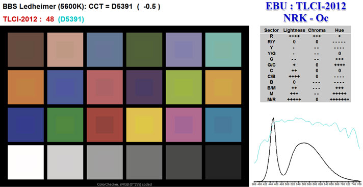

24-color samples used by TLCI

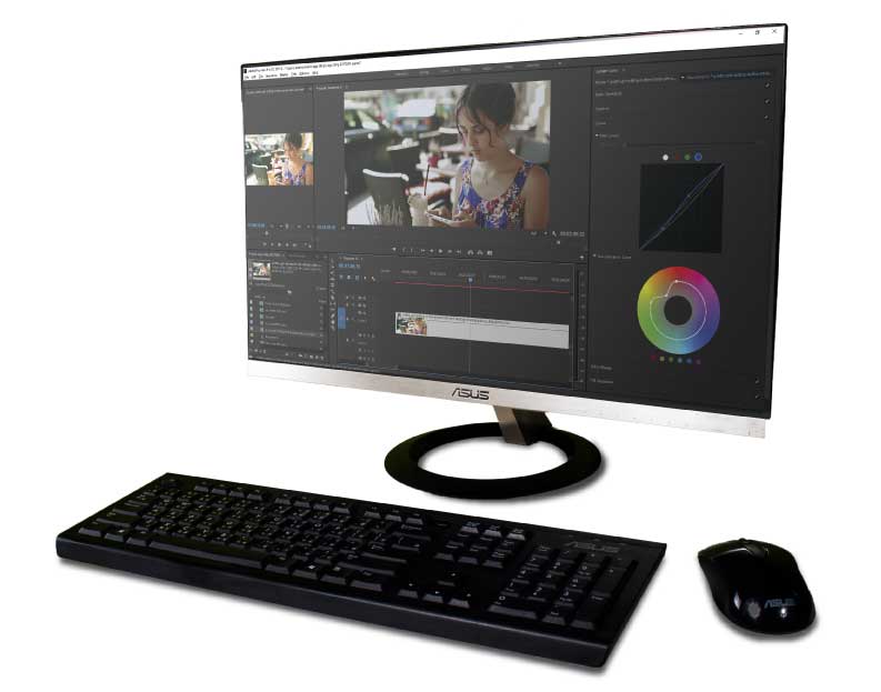

Helping the colorist​

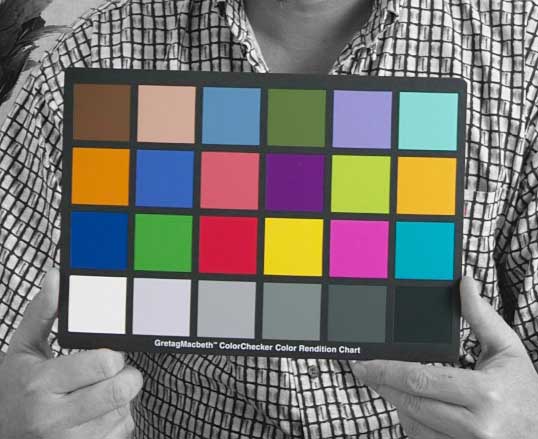

One more thing is that the TLCI score evaluates how difficult it would be for a colorist in post production to correct the colors in the video. TLCI can also be a complete package with computer software and a report (below) that is produced to tell the colorist what colors to adjust for, which is a great time saver.
Camera crews can even include a shot of a TLCI color chart at the start of a scene shoot and have post production software look at the chart (in the shot) and adjust the colors in the video automatically.
TLCI metric evaluation
85–100 errors are so small that a colorist would not consider correcting them
75–85 a colorist would probably want to correct the color performance, but could easily get an acceptable result
50–75 a colorist would certainly want to correct the errors, and could probably achieve an acceptable result, but it would take significant time to get there
25–50 the color rendering is poor, and a good colorist would be needed to improve it, but the results would not be to broadcast standard
0–25 the color rendering is bad, and a colorist would struggle for a long time to improve it, and even then the results may not be acceptable for broadcast
Meaning of TCLI scores
Color Checker Chart and TLCI report
Image courtesy of Alan Roberts.

Colorist workstation
Colorist workstation and software

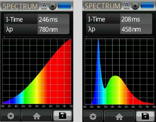

And still another color rendering index is the SSI or Spectral Similarity Index, developed by The Academy of Motion Picture Arts and Sciences. In short SSI was developed in contrast to CRI and TLCI, and focuses on the problems of Solid State Lighting (e.g. LED) used in cinematography, as opposed to traditional broad spectrum blackbody lighting. Blackbody lighting such as tungsten provides a smooth spectral distribution, which most cameras are built for. But LED lighting is “peaky” and presents new problems for cameras interpreting this kind of spectrum.

Incandescent vs. LED Spectrums

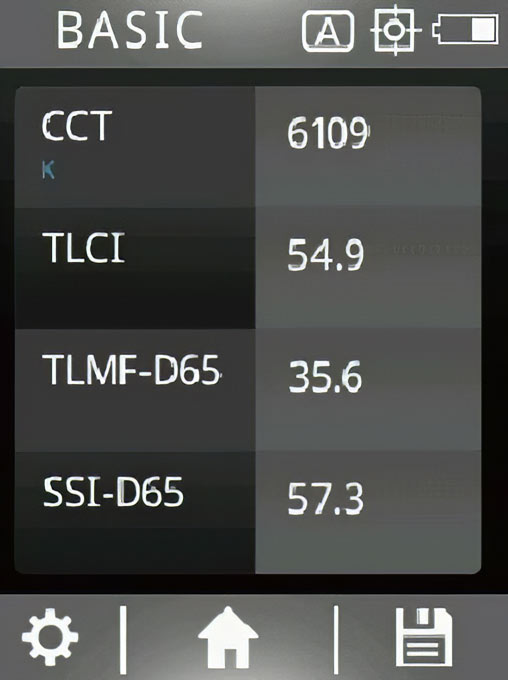

CV600 Color Rendering Metrics
TLCI, TLMF and SSI metrics measured by the UPRtek CV600 Spectral Meter
