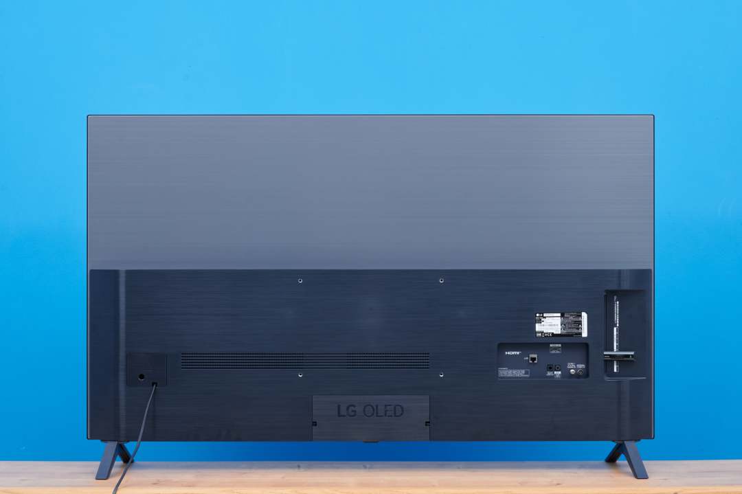

48",55",65",77"
White OLED+Color filter WRGB by LG Display (LGD)
50/60Hz panel
a7 gen4 processor (LM21U)
webOS 6.0
HDMI 2.0bx3 (eARC HDMI IN 3)
USB 2.0 x2
LG 55A1PSA look inside (Disassembled) teardown
