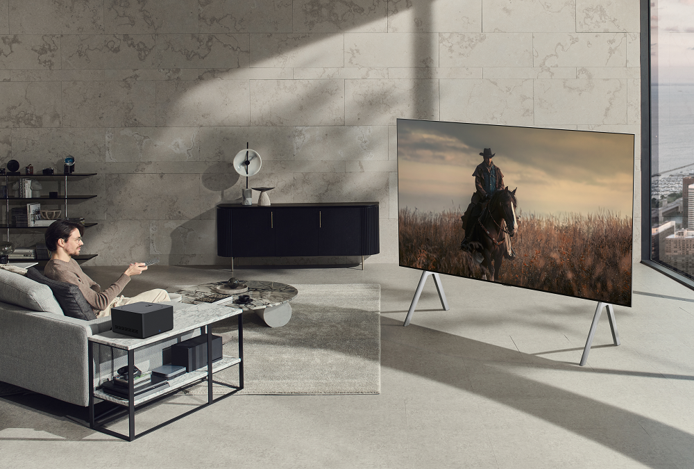

[flatpanelshd.com]...LG's new "revolutionary" M3 OLED tv features a wireless Zero Connect box...https://www.flatpanelshd.com/news.php?subaction=showfull&id=1672848000
Η LG Electronics παρουσίασε σήμερα μια νέα super high-end τηλεόραση OLED που ονομάζεται Signature M3.
Είναι η πρώτη τηλεόραση της εταιρείας με «Zero Connect», μια ασύρματη λύση για βίντεο και ήχο.
model M3
M3 as a spiritual successor to the 'wallpaper' OLED W-series that LG has discontinued
only available as a 97-inch
the TV and Zero Connect box themselves still require power from the mains
the wireless range is 10 meters
very expensive considering that the company's current 97-inch G2 has a list price of 25000 Euro / USD
World's first 97-inch wireless OLED tv that can do 4K 120Hz!

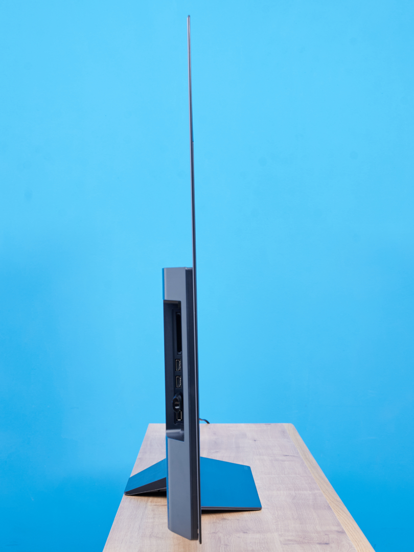

Ενσωματωμένη βάση τοίχου,προαιρετική επιτραπέζια βάση :
SR-G3WU8377: 83", 77"
SR-G3WU65: 65"
SR-G3WU55: 55" ,199€.

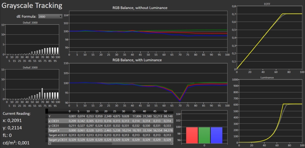

Our settings and measurements:
We set the LG 65G3 TV to Filmmaker mode and then lowered the Oled brightness to 21 and turned off the power saving mode to get a white close to 150 cd/m².
We recommend setting the TruMotion option in User mode with the De-Judder option to 4 and the De-Blur Area option to 7.
Finally, to find faithful colors in Game mode, you must set the color temperature to "Hot 50" (Settings>Image>Advanced Settings>Color>White Balance>Color Temperature).
-Labo – LG 65G3 ....https://www.lesnumeriques.com/tv-te...jamais-vu-sur-un-televiseur-oled-n208761.html
OLED Meta panel from the manufacturer LG Display.
The Vivid mode very bright, but very far from fidelity.
We measured the maximum brightness in vivid image mode with a window of only 3%.
The peak brightness reaches 1840 cd/m² (nits).
This is simply the highest luminosity measured in our laboratory.
On the other hand, in this image mode, the luminance curve is not respected at all and the TV systematically displays an image that is too bright.
Of course, the Vivid mode does not respect the original image at all.
The color temperature is whimsical and pulls way too far towards blue, while the colors are totally wrong.
We measured a delta E at 30, very, very far from the delta E of 3 below which the colors are considered faithful.

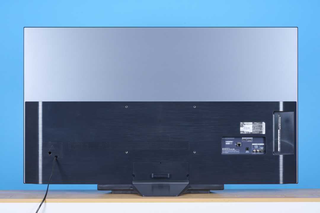

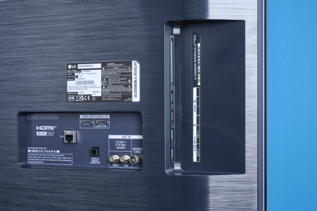

55"...[hifi.de]...LG 55B3 review...https://hifi.de/test/lg-oled-b3-test-143917
55B39LA : german market
600 nits peak brightness for HDR content
As with the content in HDR, we use the Filmmaker picture mode.
It offers the most natural colors of the work and comes close to the original intention of filmmakers.
But if you prefer more rich colors, it's worth taking a look at the other modes.
The Cinema mode, for example, looks a bit fresher, but still exudes a lot of naturalness.
By the way: Like the C3 or LG G3, the LG B3 can pass on DTS signals, including DTS:X, to external devices this year in addition to Dolby formats such as Dolby Atmos.
However, this can only be done losslessly via HDMI.
