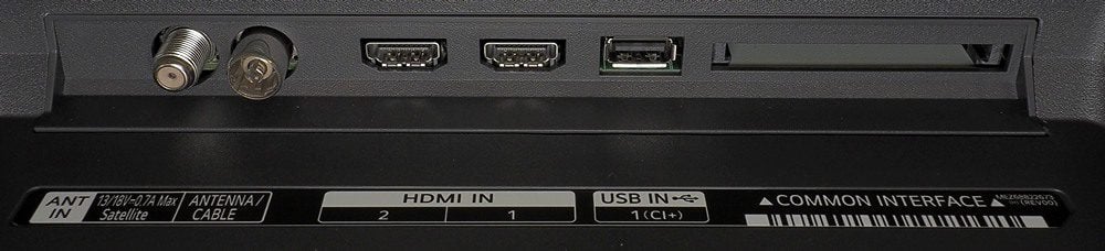

65"...[clubic.com]....LG 65C4 test...https://www.clubic.com/test-produit-529509-test-lg-oled-c4.html

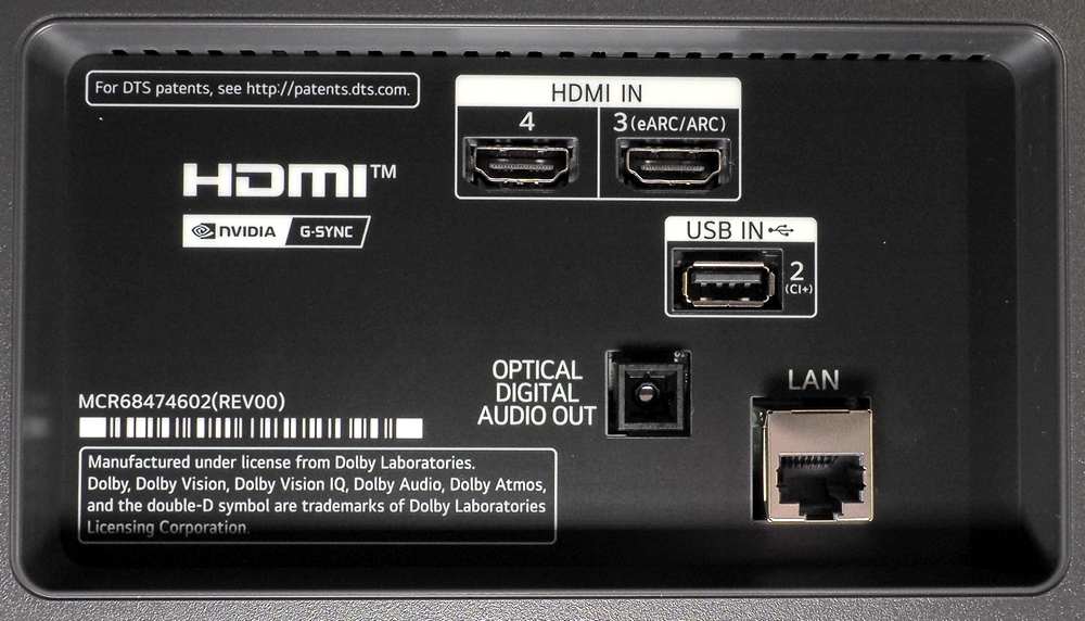

65"...[computerbild.de]...LG 65QNED85T (65QNED85T6C model) test...https://www.computerbild.de/artikel/avf-Tests-Fernseher-LG-QNED85-65QNED85T6C-review-38561259.html
ADS/IPS panel
Saemtliche-Anschluesse-des-LG-QNED85-sind-seitlich-gut-erreichbar-mit-dabei-2048x1152-5258aa54b84e25c9.jpg

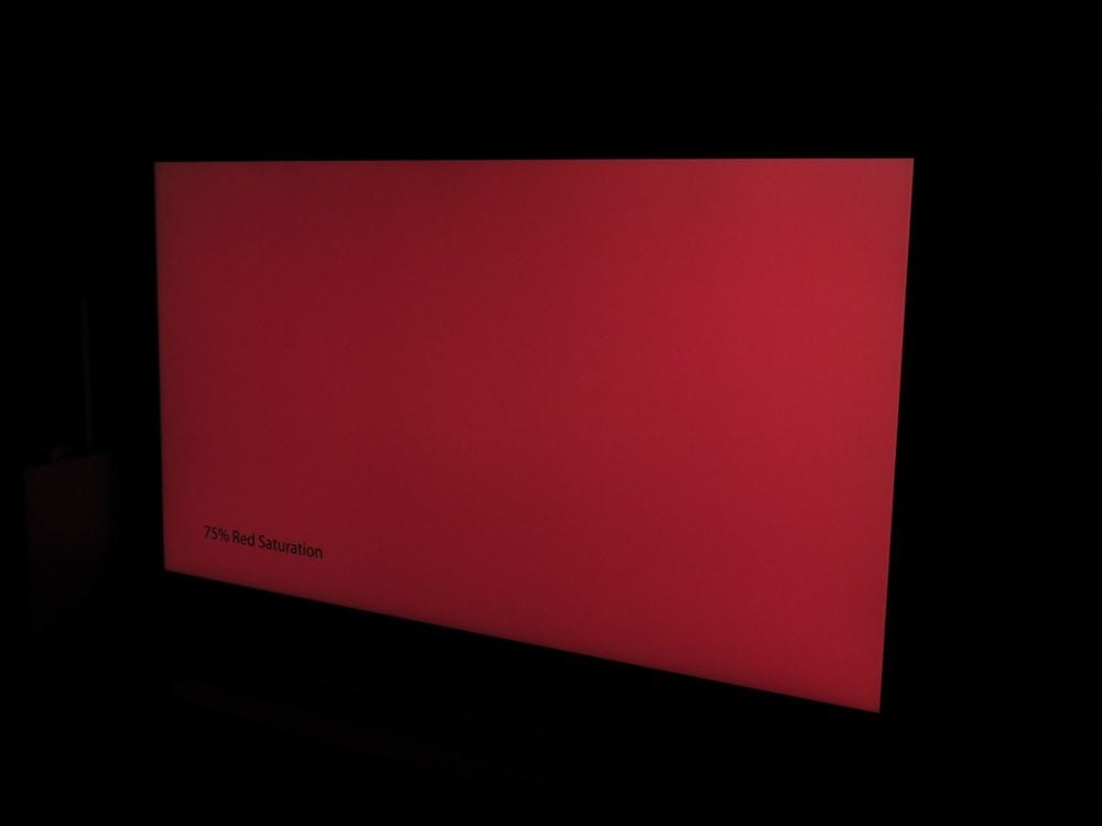

75"...[hdblog.it]...LG 75QNED86T review...https://www.hdblog.it/tv/recensioni/n583564/lg-qned86-75-test-prova/
IPS panel = native conrast ratio : just over 1000:1 in "Cinema" mode .
Edge (bottom) LED LCD
vertical local dimming
α8 AI 4K processor
100/120Hz με MCFI
acronym QNED = the backlight uses blue LEDs, which are re-emitted in green thanks to the Quantum Dot layer and in red thanks to the Nano Cells.
Color Gamut DCI-P3xy "Filmmaker" : 91.2 %
Color Gamut Rec.2020xy "Filmmaker" : 66.2 %
HDR formats supported : HDR10 , HLG,
no Dolby Vision,HDR10+.no Dolby Atmos.
HDMI 2.1 x4
USB 2.0 x2

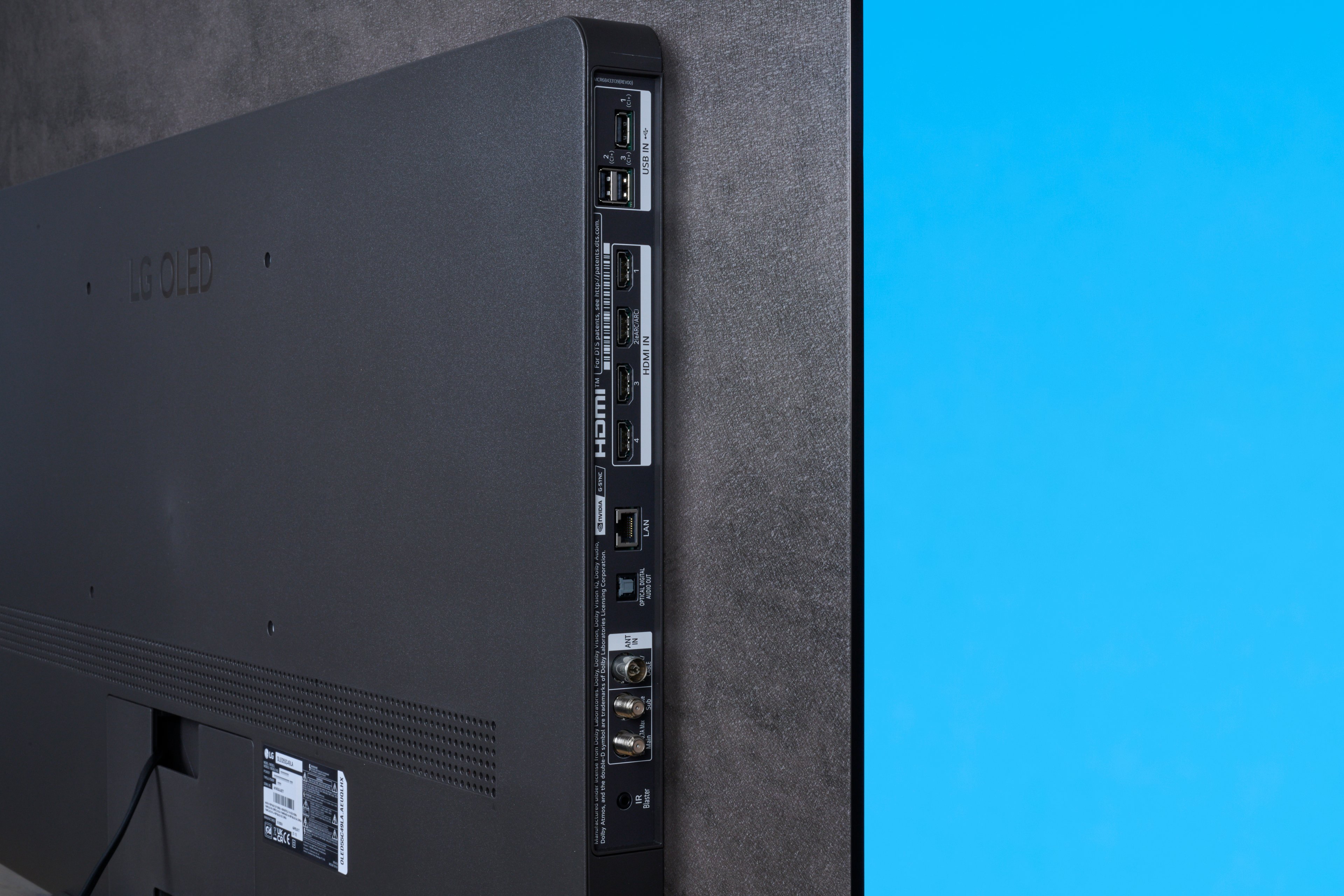

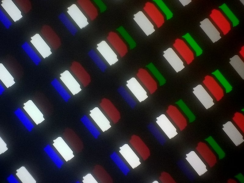

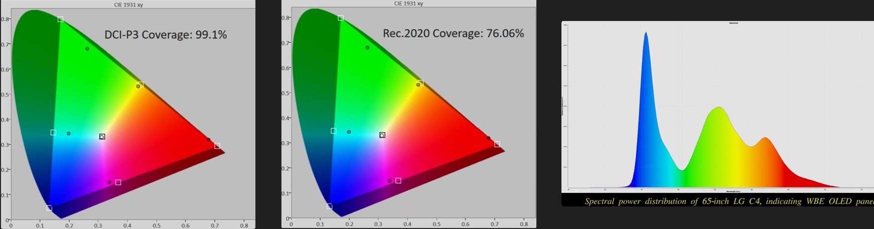

65"...[hdtvtest.co.uk]...LG 65C4 review
We review the LG 65C4 WRGB WBE WOLED tv, including comparisons vs the Sony 55 BRAVIA 8 with a Sony BVM-HX310 mastering monitor as reference.

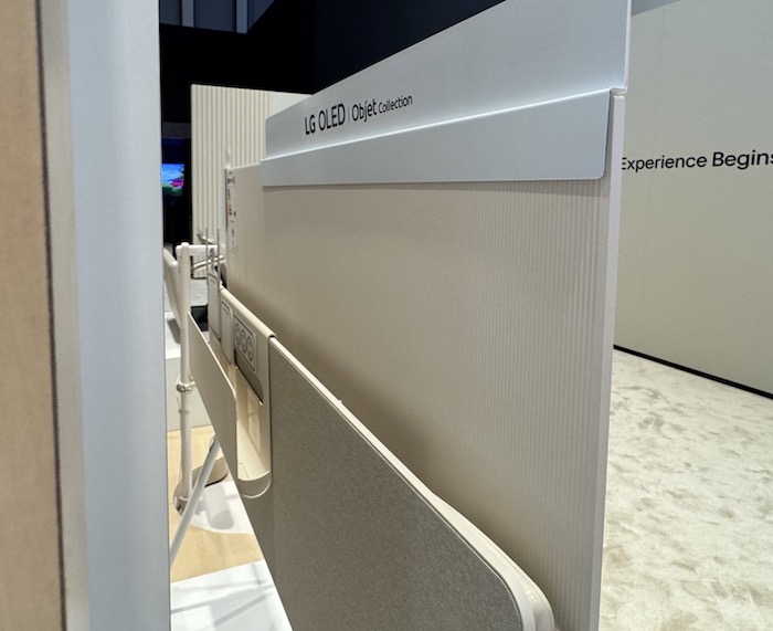

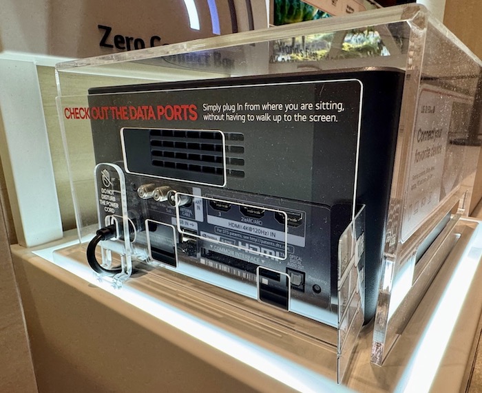

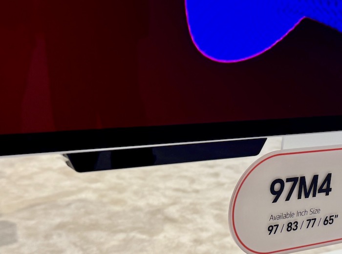

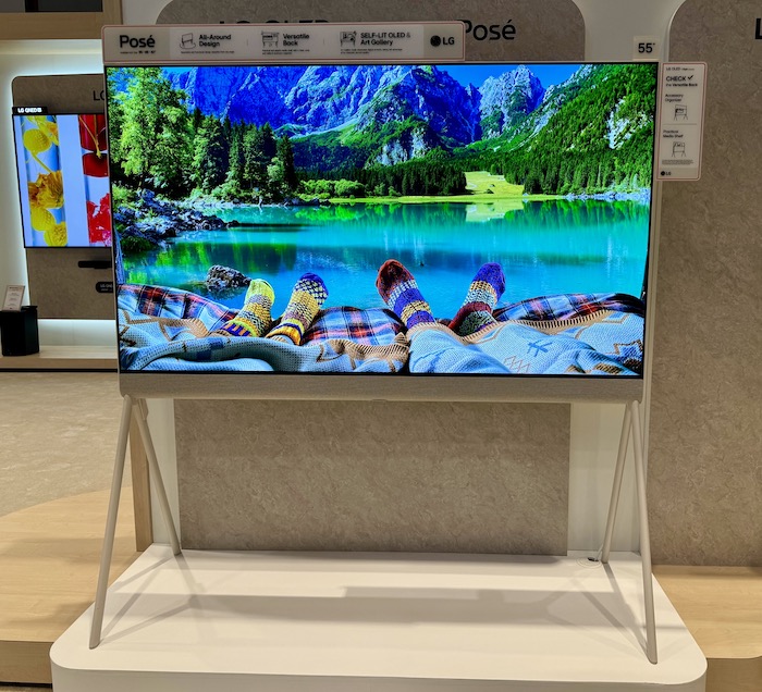

[areadvd.de]...IFA 2024: First impressions of the LG 4K WRGB WOLED tv M4 (97-inch)...https://www.areadvd.de/tests/ifa-20...l-und-vom-pose-lxt1-in-55-zoll-2024er-modell/
...the LG Posé LXT1 from the "Objet Collection" in the 2024 version,only offered in 55 inches, is also available,which is based on the LG C4.
IFA 2024: Οι πρώτες εντυπώσεις της LG 4K WRGB WOLED tv M4
LG Posé LXT1 in 55 inches

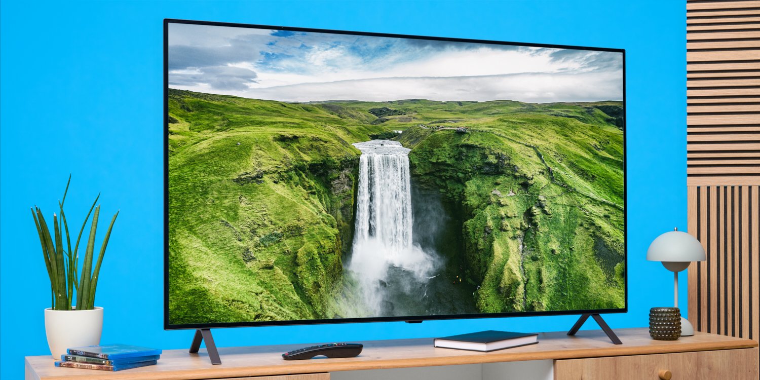

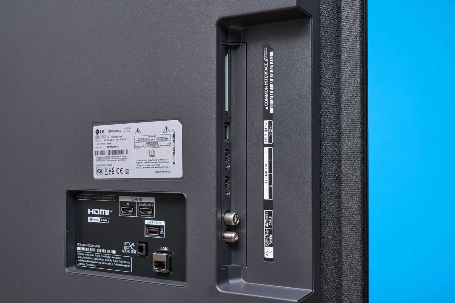

55"...[geex.x-kom.pl]...LG 55QNED87T review...https://geex.x-kom.pl/recenzje/recenzja-lg-55qned87t/
QNED87T series is a variation of the QNED85T series,αντικαθιστά την QNED826R του 2023.
ADS panel σαν τα IPS =ANSI contrast ratio 1219:1.
100/120Hz,
Edge LED LCD ( 6 dimming vertical sripes),
K24 hardware platform,a8 AI.
DCI-P3 (CIExy) color space was 92%,
HDR content ,in filmmaker preset picture mode, on a window occupying 10% of the screen area, the maximum luminance was 632nits & full-screen window, the maximum luminance 489 nits.
HDR support: HDR10,HLG
webOS24 (9.1.0-43)

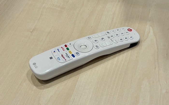

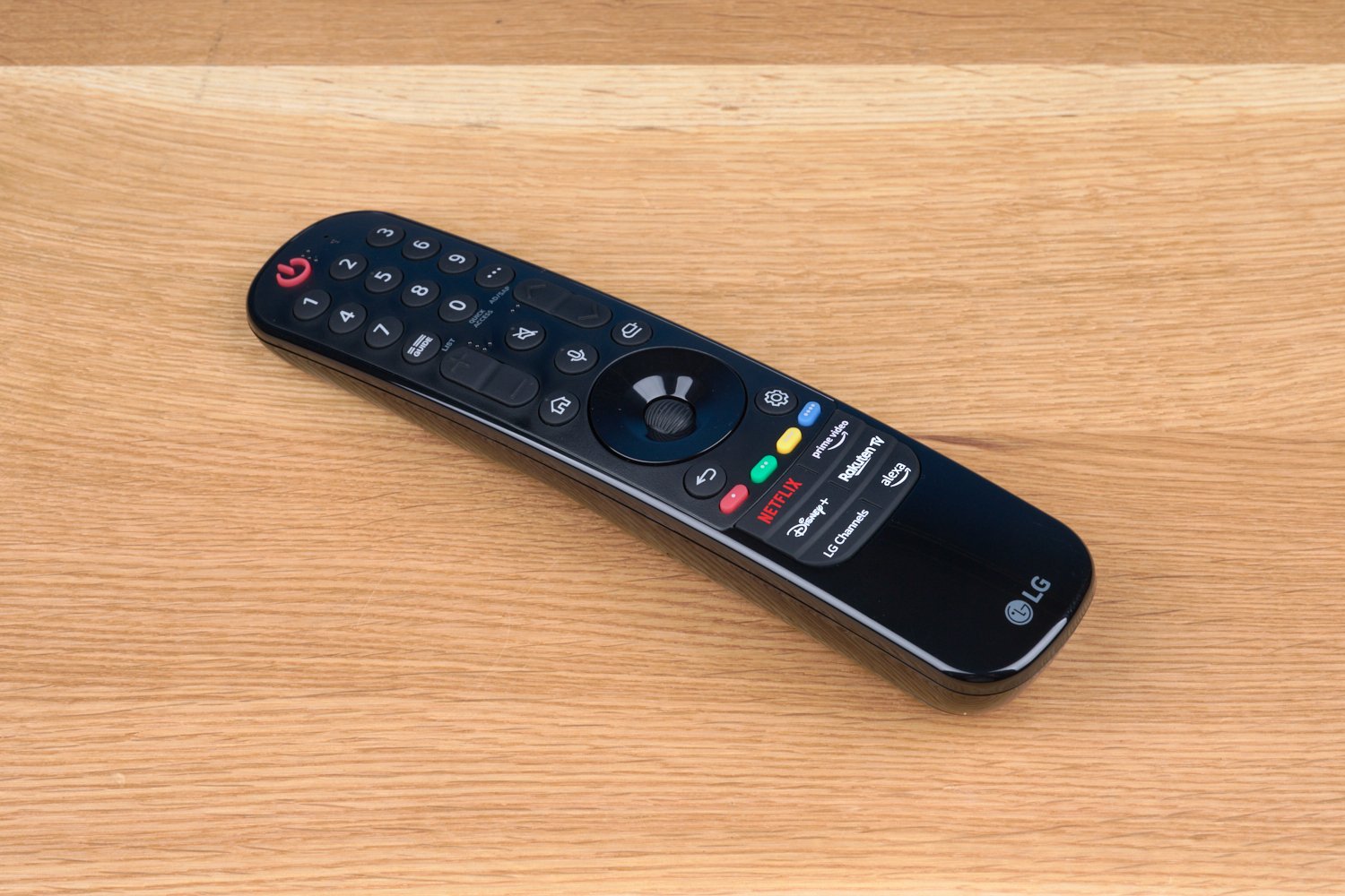

remote control : model MR24GN,same as in the C4 series.
HDMI 2.1 x4
USB 2.0 x2
Assembled in Poland

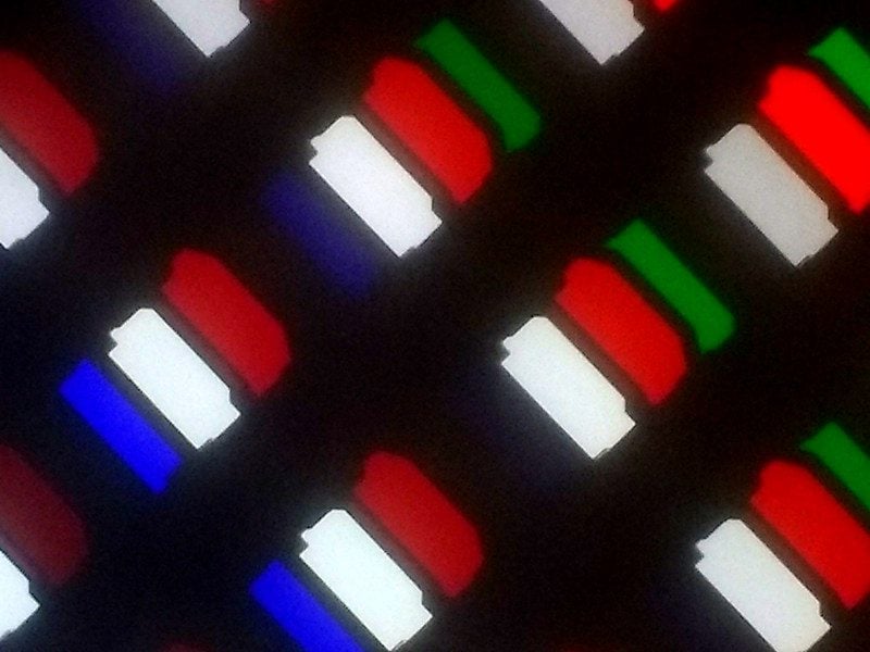

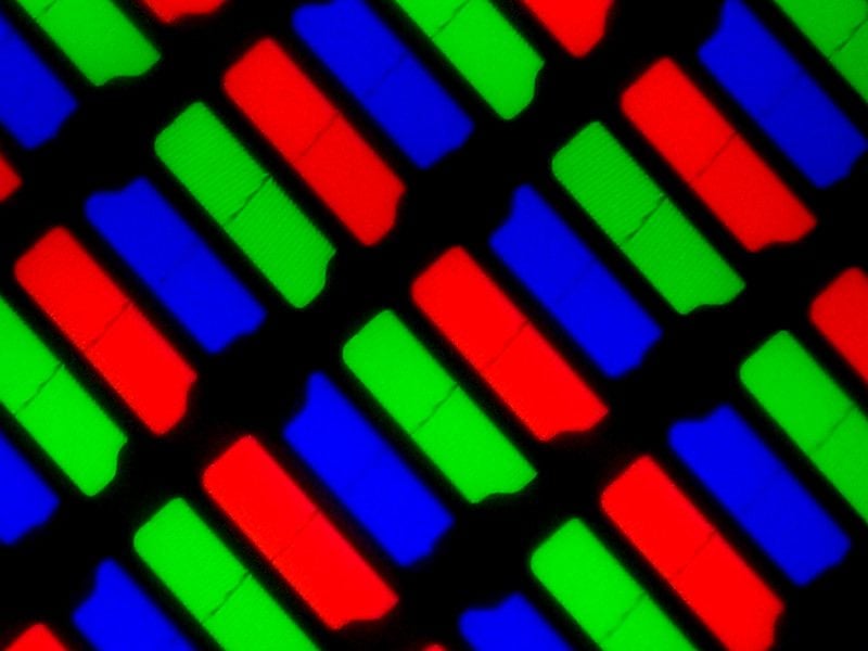

subpixel panel structure

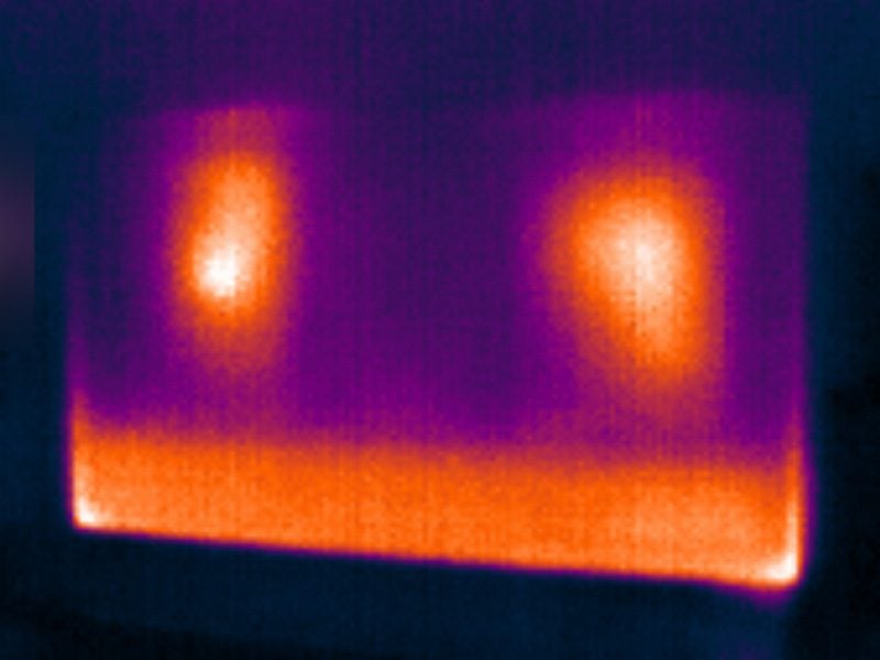

thermogram showed that edge backlighting

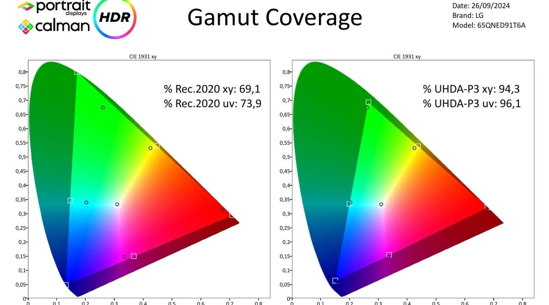

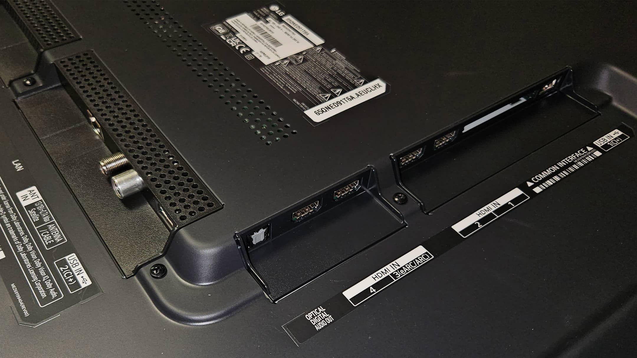

65"...[fwd.nl]...LG 65QNED91T (65QNED91T6A.AEUCLHX) review...https://fwd.nl/beeld/review-lg-65qned91t6a-qned91-serie-lcd-led-tv/
VA panel ,RBG,8 domain,vertical stripe
Direct mini LED (16x10=160 zones) LCD,ιδιες ζώνες με την Samsung QE65QN85D.
100/120Hz με MCFI+αναβόσβησμα του οπίσθιου φωτισμού
a8 processor
Dolby Vision , Dolby Atmos

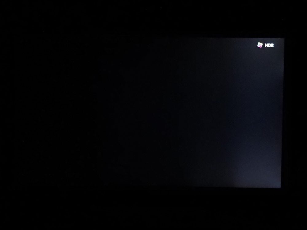

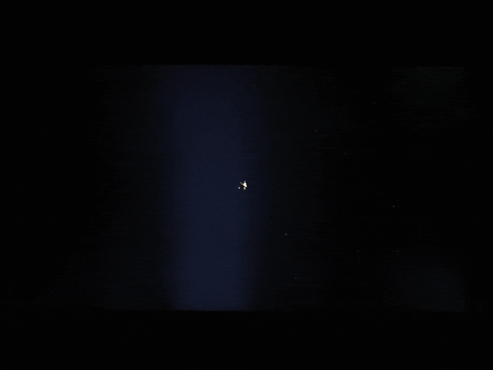

HDR
sideview blooming & halos

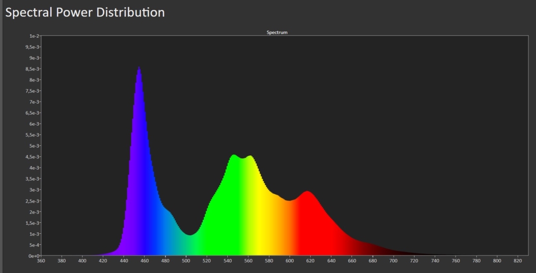

spectral power distribution (SPD)
