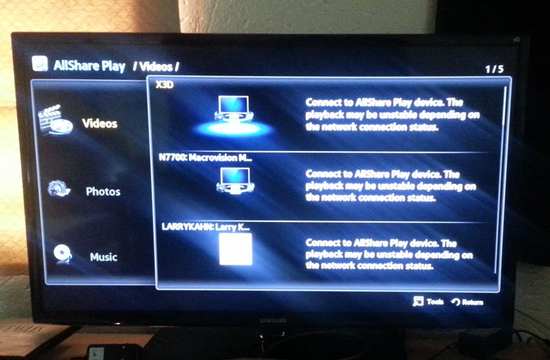

Είναι πράγματι άξιος συγχαρητηρίων ο εκπόσωπος της Mede8er. Δεν διστάζει να πει ότι το σύστημά τους δεν δουλεύει με τη Samsung! Δείτε τι μου απάντησε σχετικά με τα compatibility issues:
Hi Eric,
I did some tests for you and you can see in attached image the Samsung picks up the X3D and you can navigate it. Most video files mkv type and xvid show unsupported but mp3 music played ok. I don’t think this is a solution and you will be pulling your hair
out very soon as the new Samsung TV lost network many times during my testing and had the same results when connecting to my PC.
In my opinion this is not a option I would never personally do this. Best reliable way is to get a MED600X3D for each TV and then you can stream from any Samba source on your network and from a USB Drive connected to either MED600X3D by using Samba Process 'NAS' function. I know this is probably not what you wanted to hear but this is the only way we can be assured that you would be streaming reliably.
Rgds
Larry Kahn
Managing Director
Sanji Electronics (Pty) Ltd
