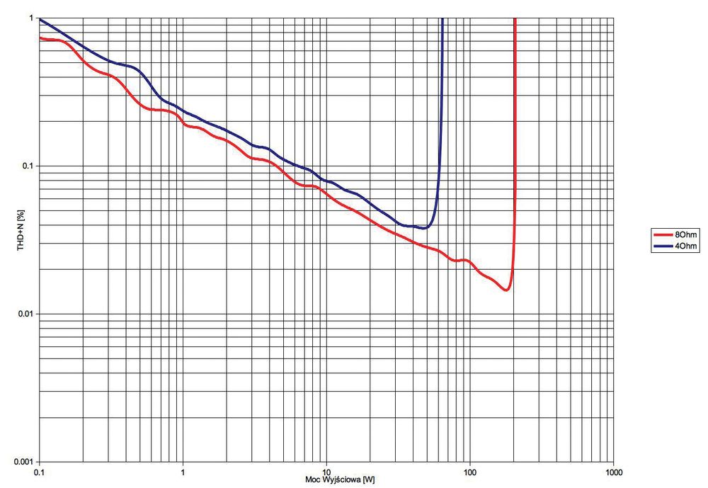

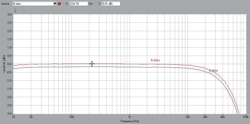

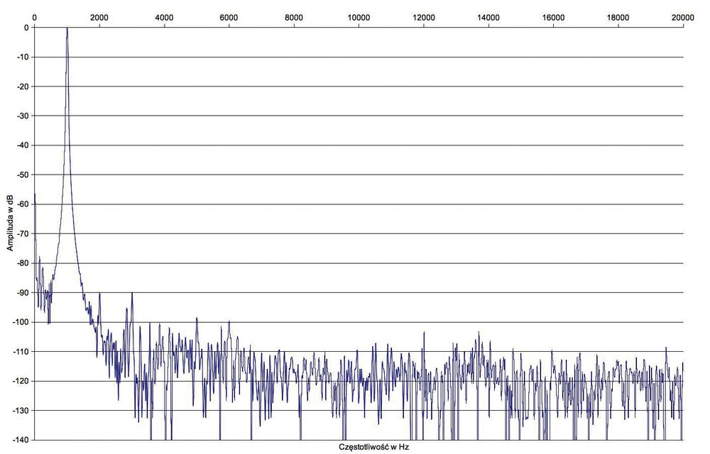

https://audio.com.pl/testy/kino-domowe/wzmacniacze-a-v/3281-denon-avc-x6700h
When driving two we get 2 x 170 W, connecting the next ones is a challenge for a common power supply, but 5 x 110 W is still an excellent result, just like 7 x 90 W, and when all eleven are loaded, we get 11 x 58 W, but then we hear intense work fans, yet the housing gets very hot. In practice, the effect channels sound less intensely than the front ones, so such extreme situations will not occur in normal use.
Και όπως πάντα με τη ρύθμιση στα 4Ω που περιορίζει την ισχύ στο τροφοδοτικό:
Denon configured the system very cautiously, not for the first time. With one channel controlled, the power is only 64 W, but for consolation it does not drop significantly when connecting other channels - in stereo we have 2 x 64 W, and when running the entire arsenal - 11 x 44 W.
