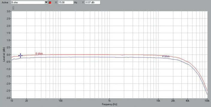

Fig. 1. Bandwidth.
Fig. 1. Bandwidth.

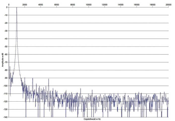

Fig. 2. Harmonic distortions.

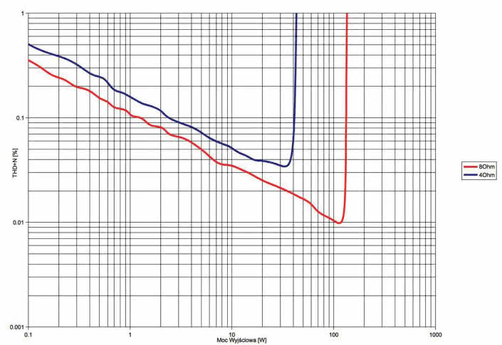

Fig. 3. THD + N / power.

Denon gives power at 8 Ω, it is supposed to be 80 W, but note: at a much lower than the standard THD + N level - 0.08%. So, at 1%, you can expect better results… and they are actually better, and much better.
With 8 Ω and two channels driven simultaneously (i.e. in stereo operation) we have as much as 2 x 121 W - that's well over two times more than with the Onkyo and Pioneer.
When connecting subsequent channels, the power drops systematically, through 5 x 63 W to 7 x 49 W, but in each configuration the Denon has an advantage. Its Achilles' heel is the power drop when turning on the impedance selector in the 4-ohm mode.
Then the power drops dramatically, to just over 40 W in each channel, although no matter how much we load them at the same time. We know Denon receivers for this safety-related behavior, resulting from the superiority of the goal of reducing heat generation (which would increase even with the same power on a 4-ohm versus an 8-ohm load).
As much as such a margin of safety seems excessive, but we can ignore these recommendations, resulting more from the applicable safety standards than trying to obtain the best parameters and sound, leaving the 8-ohm mode also with a 4-ohm load (especially that we may not even be aware of that we are dealing with such impedance, because loudspeaker manufacturers promise 8 Ω more often than they should). Then the AVR-X1700H will go to the max and squeeze out almost 2 x 200 W!
Or almost 5 x 140 W, only with seven channels driven at the same time the power drops significantly - to 7 x 57 W, when the receiver turned off. In practice, such tuning of all channels will probably not happen.
