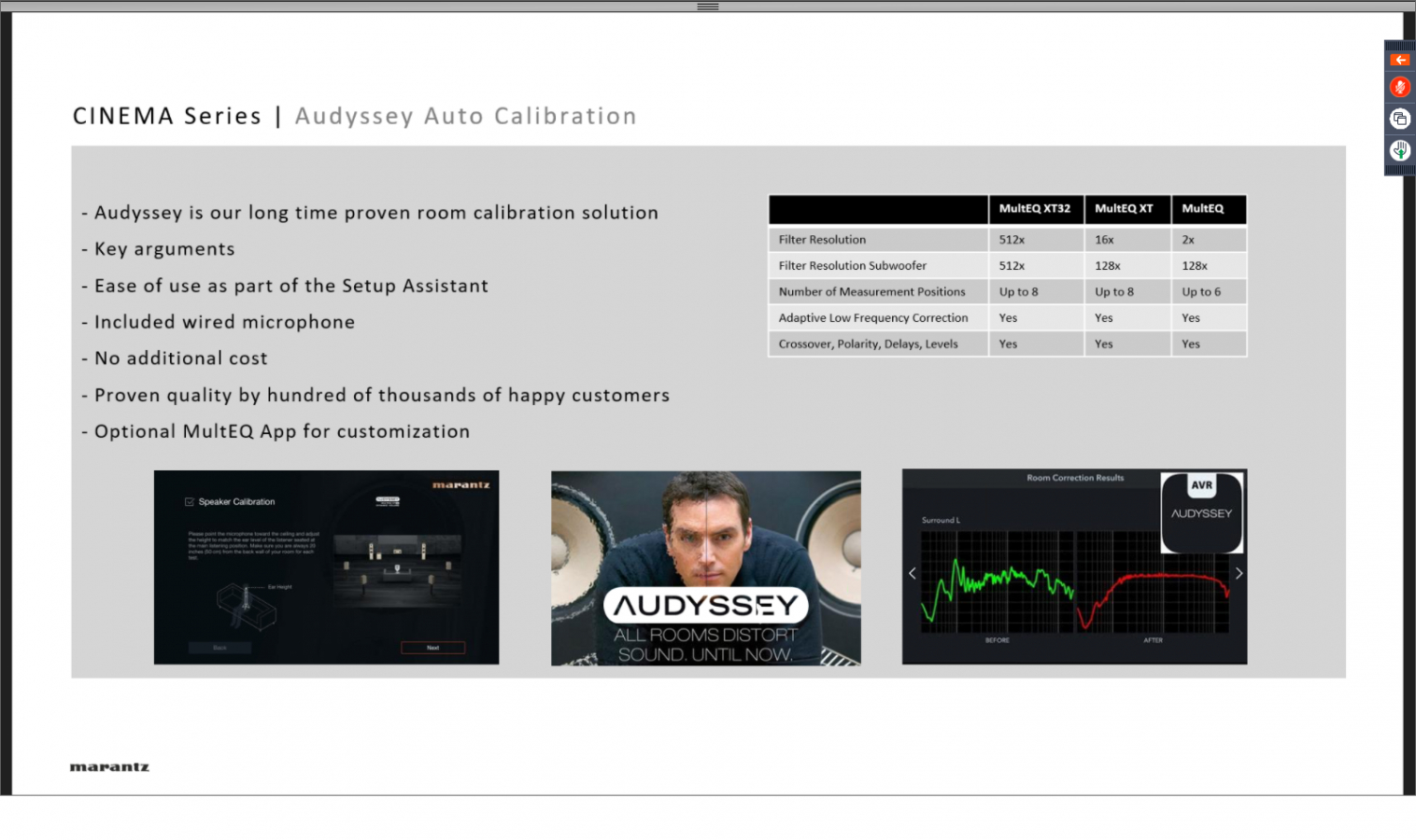

Φυσικά, το Audyssey παραμένει ως έχει.

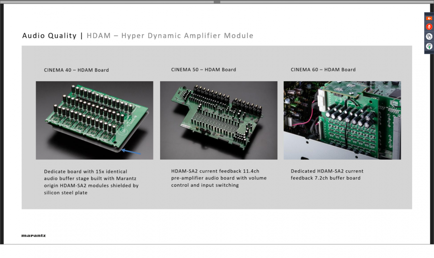

Το HDAM SA-2 Board στον Cinema 40 και οι διαφορές σε σχέση με τους Cinema 50 και 60.

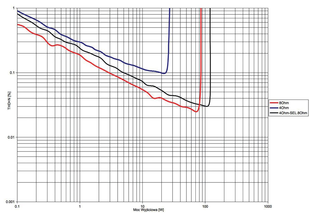

O μικρός Cinema 70s σε τεστ με μετρήσεις.
With one channel driven we get 85 W, with two (so in stereo) - 2 x 71 W. Now we jump to the simultaneous driving of 5 channels (these are still popular installations) and we have 5 x 40 W; at seven: 7 x 28 W. The drops are, of course, due to the limited capacity of the power supply. The "official" 50 W can be approximated by driving 4 channels at the same time.
