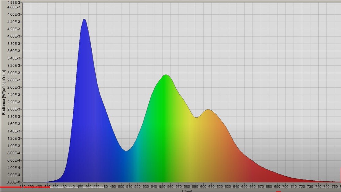

LG 55G1 EVO panel from LG Display's Guangzhou, China, fab_spectral power of distribution

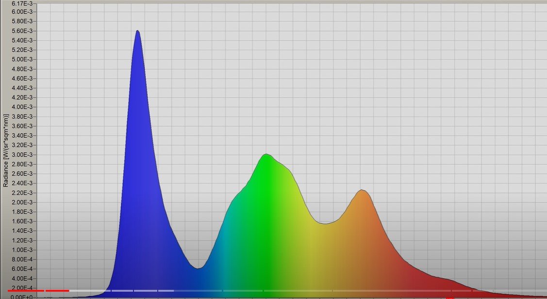

LG 55C1 panel_from LG Display's Paju, South Korea, fab spectral power of distribution

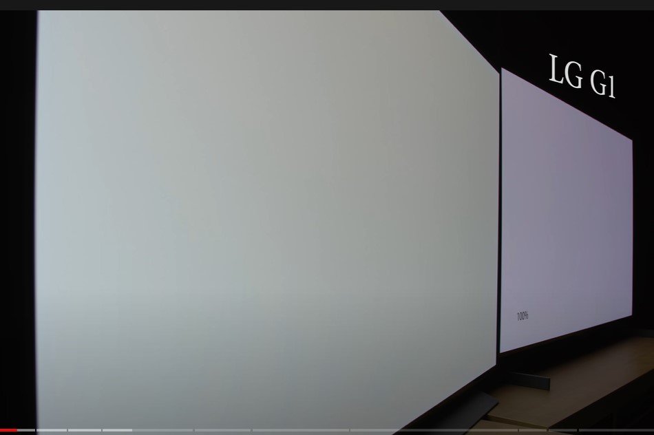

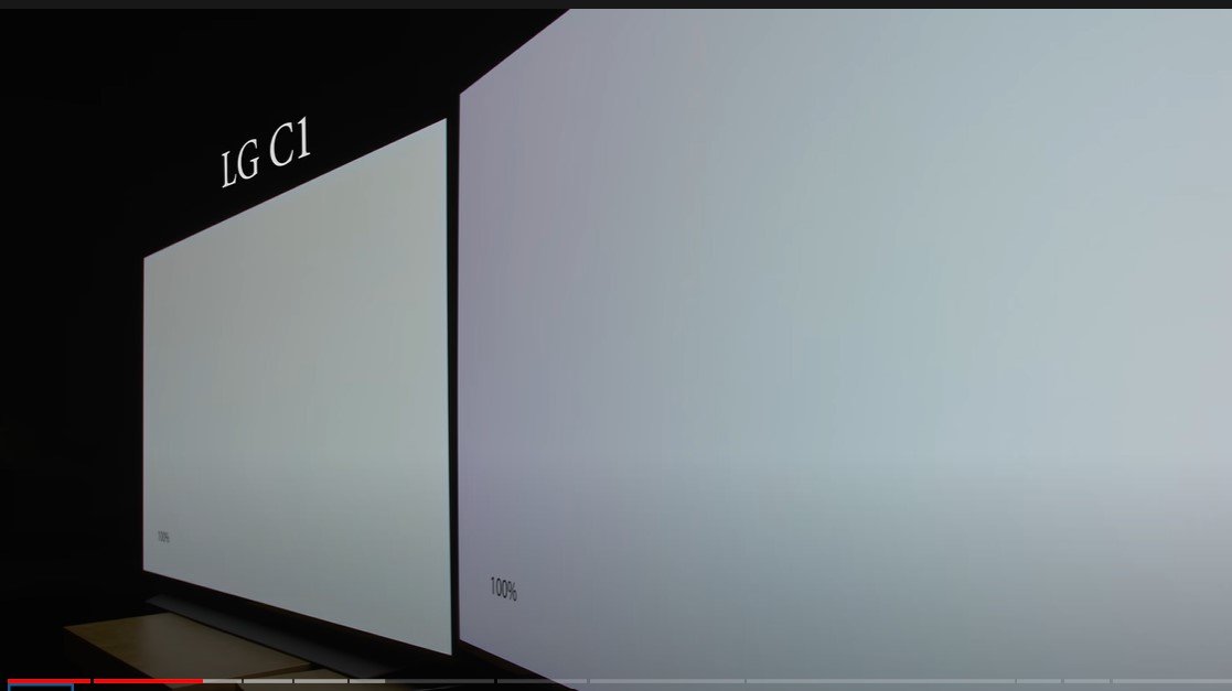

LG 55C1 Paju fab vs LG 55G1 Guangzhou fab_tint off center
