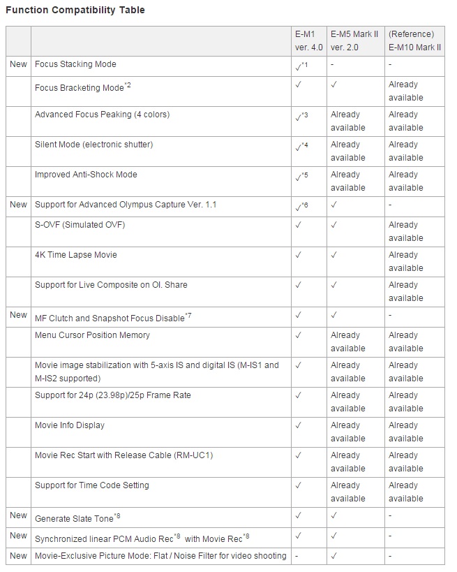

Δυστυχως καποιες λειτουργιες θα ειναι συμβατες με καποιους φακους μονο , βαζω τις διευκρινήσες:
cbdd2d25621e436eae42a6caa328d20f
*1 The following 3 lenses are compatible: M.Zuiko Digital ED 60mm f2.8 Macro, M.Zuiko Digital ED 12-40mm f2.8 PRO, and M.Zuiko Digital ED 40-150mm f2.8 PRO. Approx. 7%of the top and bottom, left and right are cut out from the composited image.
*2
Micro Four Thirds standard AF lenses are compatible.
*3
Focus Peaking is not available while recording movies.
*4 Supported shutter speeds are 1/8 to 1/16000 sec, and supported ISO speeds are ISO LOW to 3200.
*5 Adds sequential shooting in Anti-Shock mode when the time from a full press to the beginning of exposure is set to 0 sec. and first-curtain electronic shutter will be used all delay times.
*6 Except for High Res. Shot.
*7 Applicable lens firmware update required for MF Clutch mechanism and Snapshot Focus mechanism.
*8 Supported with Olympus Linear PCM Recorder LS-100.
