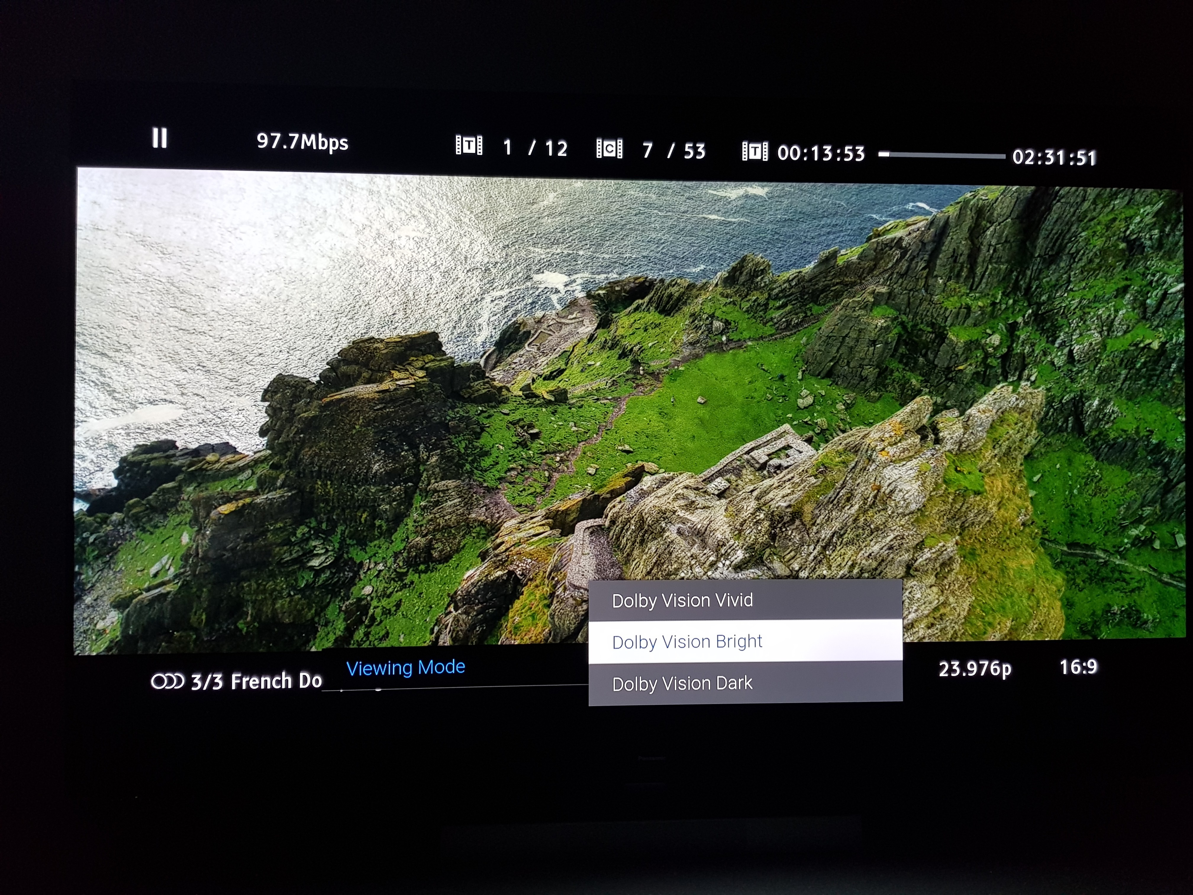

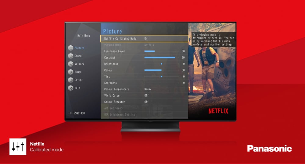

[TD="colspan: 5, align: center"]
Dynamic / Normal / Cinema / True Cinema / THX 4K (Cinema / Brightly Illuminated Room) / Personalized / Professional Photo / Professional1 / Professional2 (isfccc)[/TD]
[TD="colspan: 2, align: center"]
Dynamic / Normal / Cinema / True Cinema / Consumer / Sports / Game / DolbyVision (Live / Bright / Dark)[/TD]

[TR]
[TD="bgcolor: #40E0D0"]
NETFLIX Calibration Mode
[/TD]
[TD="colspan: 4, align: center"]
Yes[/TD]
No[/TD]
[/TR]
