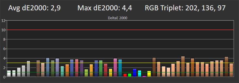

[geex.x-kom.pl]...Philips 55OLED754 test...https://geex.x-kom.pl/recenzje/philips-55oled754-test-i-recenzja-telewizora-oled-z-systemem-saphi/
Colors
The only factory mode with normal, ie, unpainted colors was, as expected, a "film". In this mode, the white was only a little warmer than it should be (6312K instead of 6505K), but this did not prevent us from getting good color reproduction (although not as good as in the more expensive 854 model).
The colors on the 55OLED754 screen are generally well saturated, while the analysis of the measurements showed that they are a bit brighter than they should be. If we lower the overall brightness (contrast option) from the factory 70 to 35, the average RGBCMY color mapping error will drop from 2.77 to 2.4.
