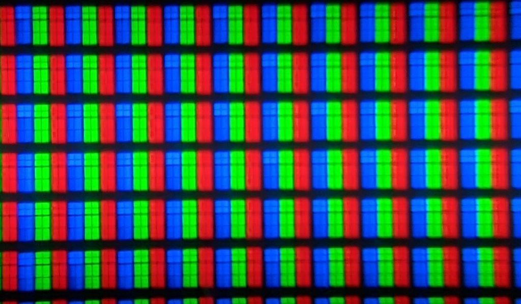

QE Q80T : VA panel RGB vertical stripe,

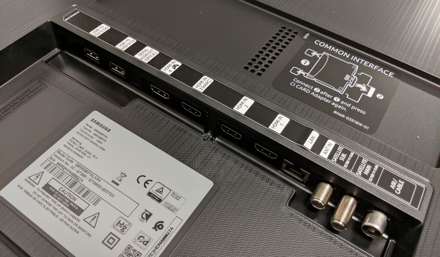

HDMI 2.1 port 4:eARC port 3
no Divx and no xVid formats from the media player. no DTS soundtracks either,no Dolby Vision.
Connections:
4x HDMI (3x v2.0, 1x v2.1 (40 Gbps), eARC, ALLM, VRR, HFR),
1x optical digital out,
2x USB 2.0,
Bluetooth (A2DP),

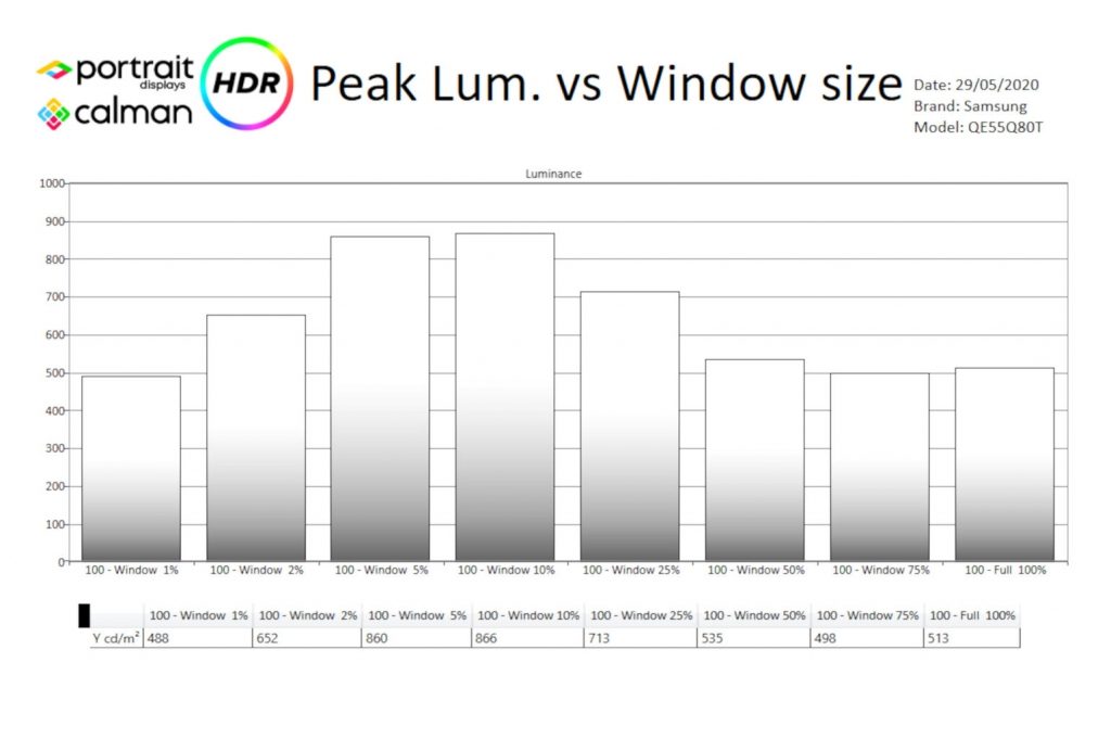

HDR peak brightness on 10% window measured: 863 cd/m2
Peak light output on full field : 506 cd/m2

-In HDR mode on the 10% board, the maximum luminance after three minutes of measurement was as much as 860 cd / m ^ 2.

As you can see in the results above, the Q80T doesn’t hold onto the same peak brightness at different window sizes and actually looks more like the performance you would see from an OLED panel. The reason for this is the local dimming algorithm and blooming suppression in the 1, 2 and 5% window sizes, so whites are not blooming against black backgrounds. At 10% we get the full 1000 nits performance capability of the Samsung, but this then falls back as the windows get larger to a reasonable full-screen brightness of 559 nits. This appears to be deliberate use of the local dimming to achieve better performance and less blooming with HDR content.
