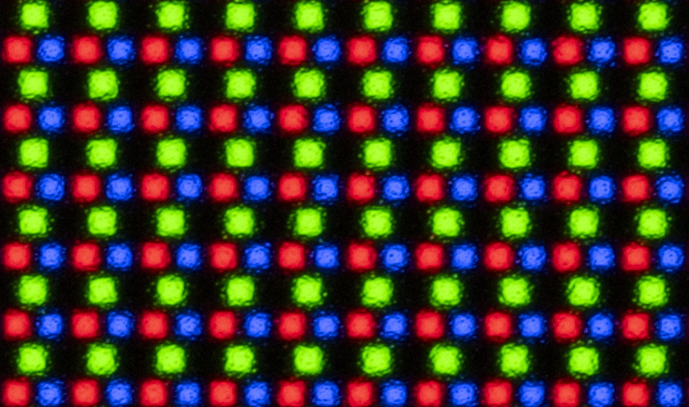

QE S95F σειρά:
RGB QD-OLED panel από Samsung Display εκτός από τις 83" που είναι WRGB WOLED panel από LG Display ,
Panel type : Triangular RGB QD-OLED by Samsung Display (SDC)
Screen Finish : Matte
100/120Hz panel με MCFI,
Tizen OS 9.0
doesn't support: Dolby Vison, DTS formats ,PVR
Αντικαθιστά την QE S95D

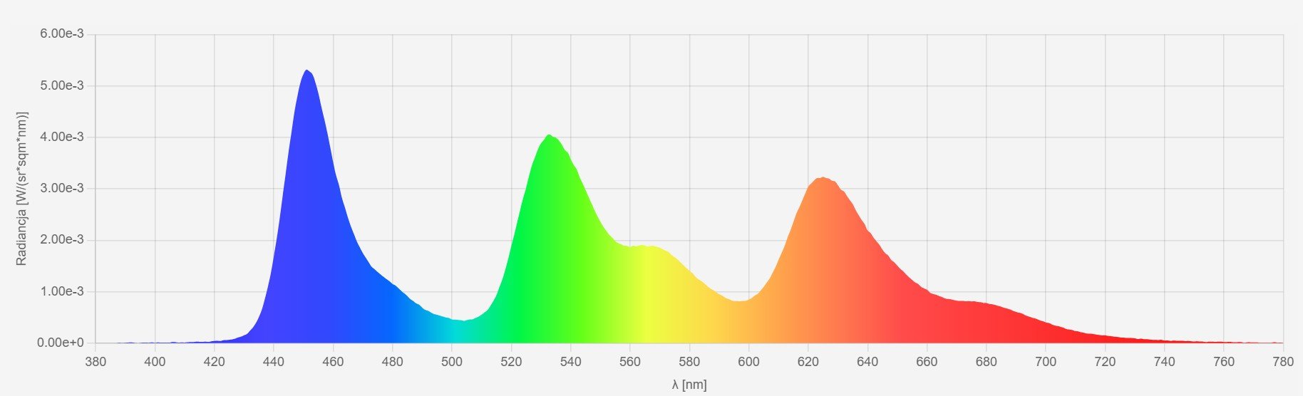

83"...[wybierz.tv]...Samsung QE83S95F test...https://www.wybierz.tv/telewizory/testy/samsung/samsung-oled-s95f-tandem-oled_AFZ
WRGB WOLED 'four-stack' panel by LG Display + Samsung's matte finish

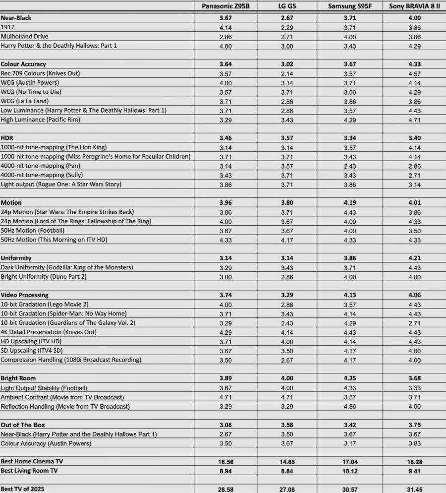

-HDTVTest 2025 TV shootout-...https://avclub.gr/threads/samsung-tv-line-up-2025.183119/post-1059104121
Our 2025 TV shootout between the LG G5 & Panasonic Z95B 4-stack WOLED TVs + Samsung S95F & Sony BRAVIA 8 II QD-OLEDs.
