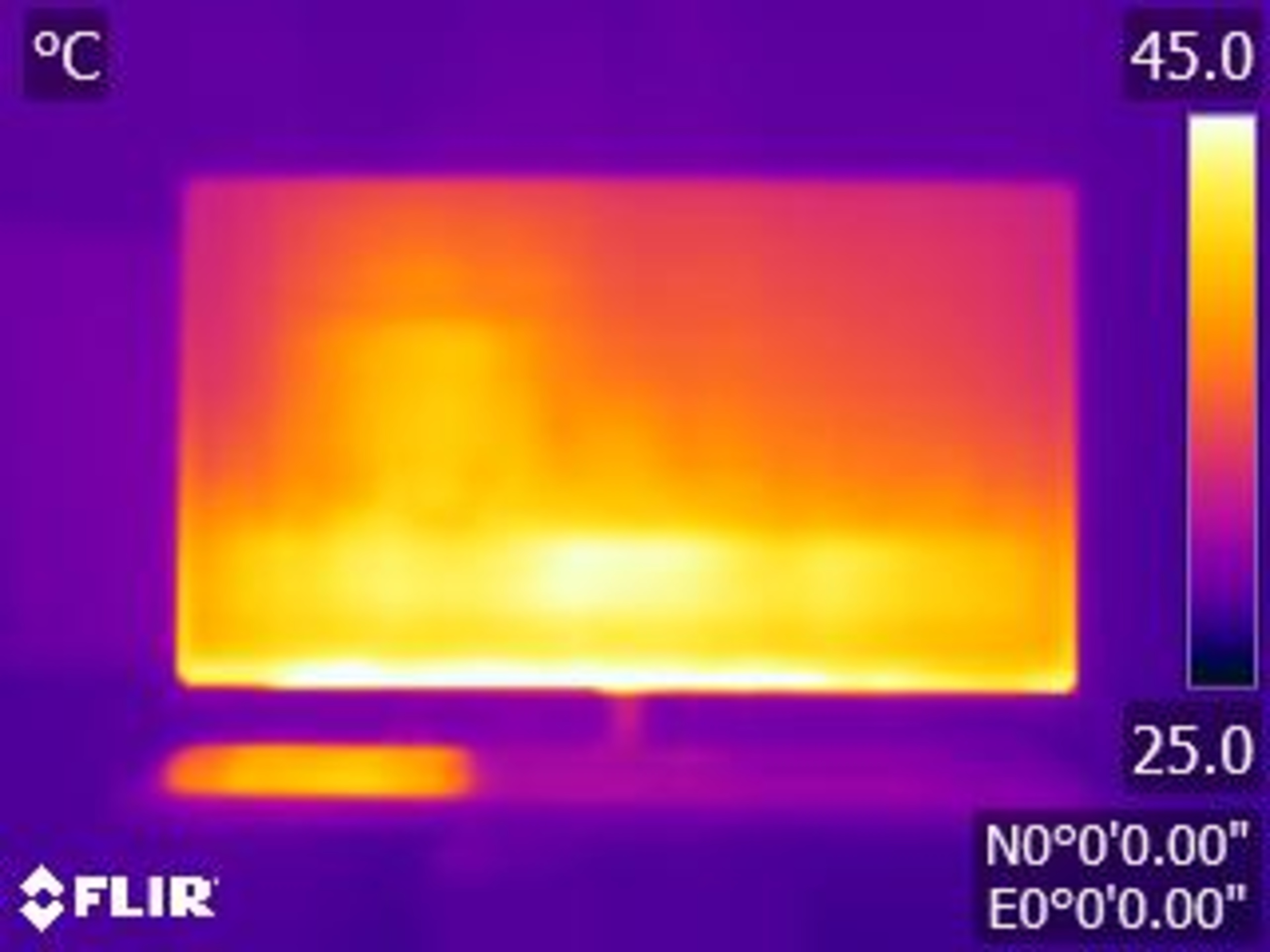

QN55Q7F:Edge LED(only bottom),local dimming,VA panel (RGB),100/120Hz + αναβόσβησμα του οπίσθιου φωτισμού

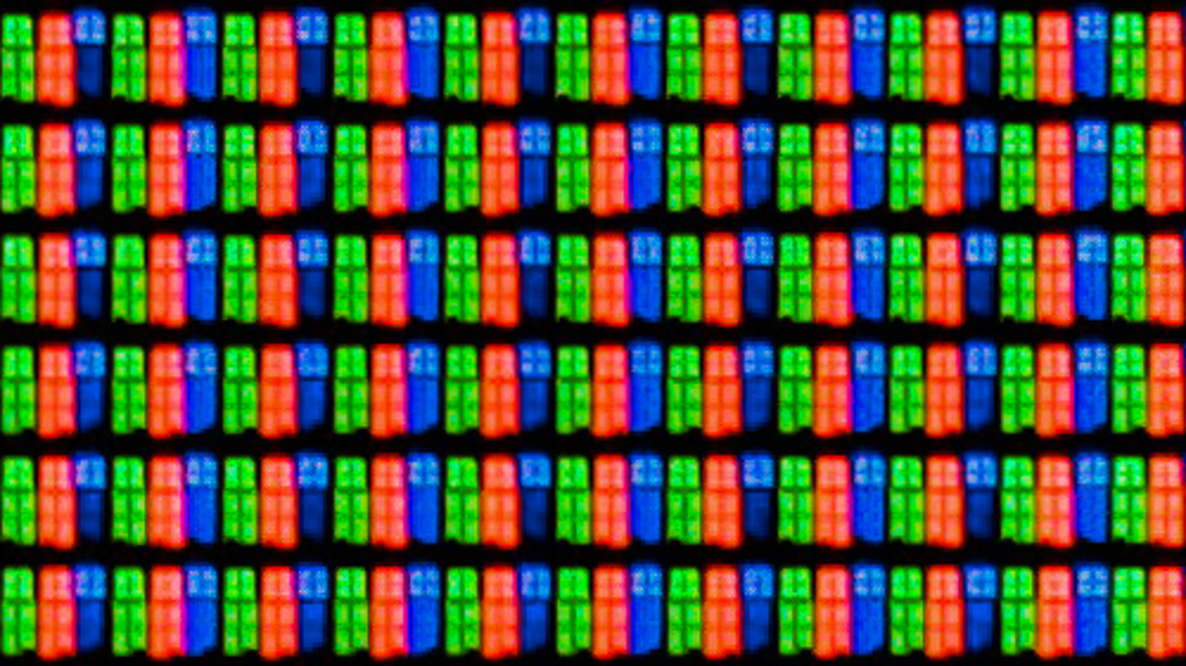

QN55Q7F:subpixel panel structure,VA panel (RGB),100/120Hz + αναβόσβησμα του οπίσθιου φωτισμού
source photos:[rtings.com]

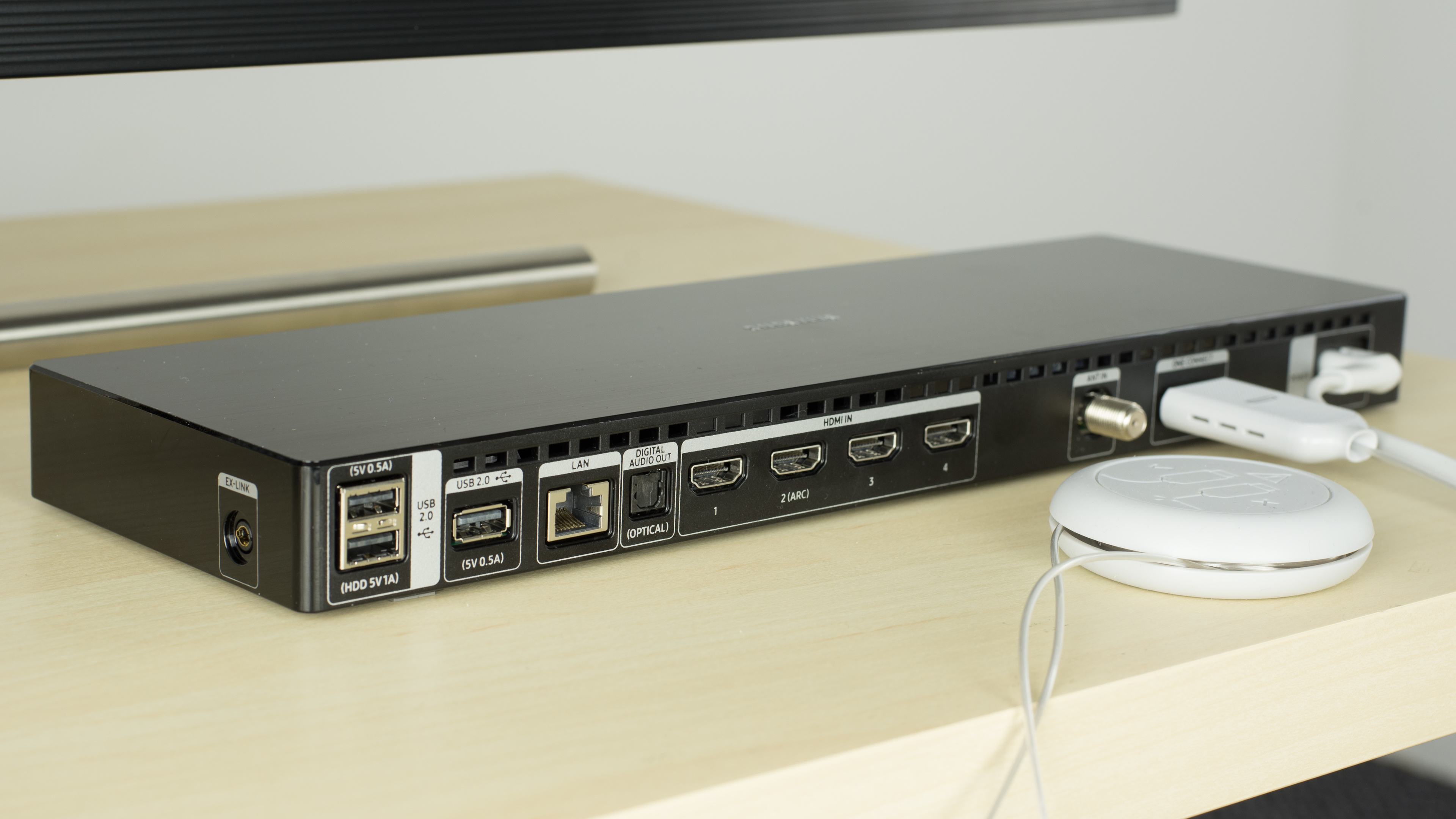

Electronics and remote connection in the One Connect box

[TD]2 x USB 2.0 (DC 5V MAX 500mA)
1 x USB 3.0 (DC 5V MAX 900mA)
1 x Ethernet RJ45
4 x HDMI 2.0a - HDCP2.2 (ARC, CEC, MHL 3.0)
1 x AV Cimposite in
1 x AV Component In
1 x Optical Audio Out (AAC/PCM/AC3/Dolby/DTS/DTS Neo2.5)
1 x Antena (RF) (female)
1 x CI+ 1.3
1 x RS.232C
Compatible Rec.2020 input
Invisible Connection
Due to the OneConnect box, the only two cables into the back of the TV are the optical OneConnect cable and a power cable. These can both be hidden behind panels. The OneConnect box and the TV each require a separate power cable.

[TD]74.5"
QDCF-MVA (Samsung Display),
3840x2160,
RGB,
10-bit,
120/100Hz
64.5"
QDCF-MVA (Samsung Display), 3840x2160,
RGB,
10-bit,
120/100Hz
54.5"
3840x2160,
RGB,
10-bit,
120/100Hz,
Flat
48.5"
QDCF-MVA, 3840x2160,
RGB,
10-bit,
120/100Hz,
Flat

[TD]Maximum Temperature: 46 °C
Average Temperature: 38 °C
1 x Ethernet RJ45
1 x AV Cimposite in
1 x AV Component In
1 x Optical Audio Out (AAC/PCM/AC3/Dolby/DTS/DTS Neo 2.5)
1 x CI+, (Version 1.3)
1 x RS.232
15 meters optical cable - Invisible Connection
