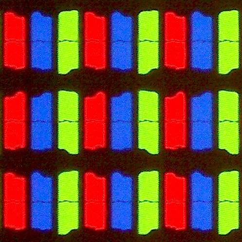

Macro shot of subpixel structure confirming RGB VA-type LCD matrix

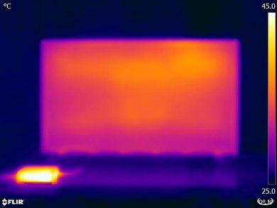

Thermal scan showing bottom-lit LED configuration...we counted between eight and ten vertical columns of independently dimmable zones, each spanning the entire height of the screen...

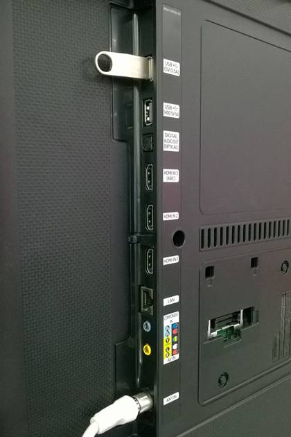

UE55MU6102:PLS panel,like IPS,50/60Hz + αναβόσβησμα του οπίσθιου φωτισμού,true 4K UHD.
connections:3 x HDMI,1 x Component in, 2 x USB, 1 x Ethernet, optical,- no headphone jack, - Bluetooth headset not supported.
