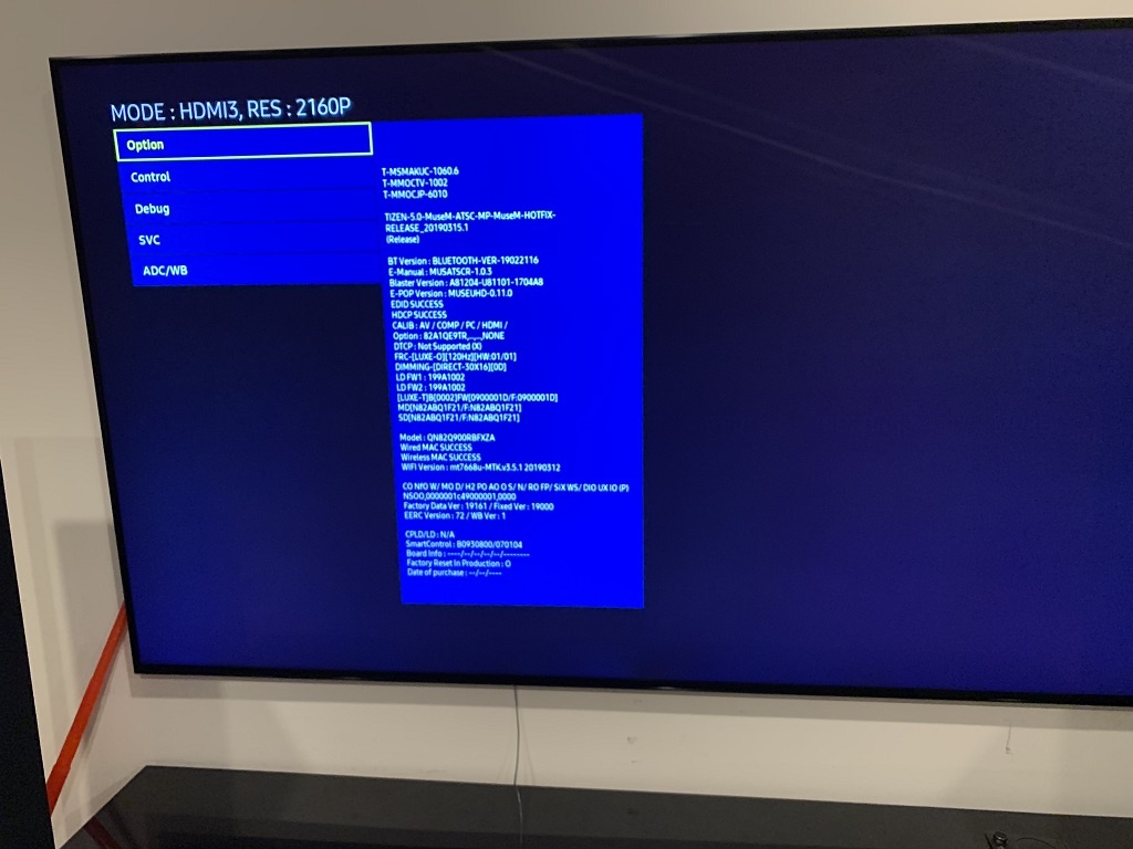

...Here a screenshot of the service menu of an QE82Q950RB (QN82Q900RB_USA)...
Panel type: 82A1QE9TR , A=panel by Samsung Display
Platform : MuseM

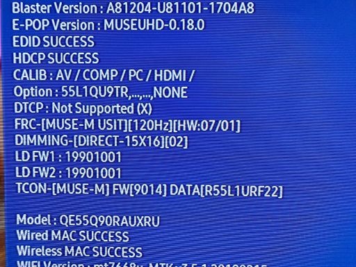

...And 240 zones on the QE55Q90RA (less than the 320 on the QE55Q9FN):
Panel type: 55L1QU9TR , L=panel by AU Optronics ?
Platform : MuseM
